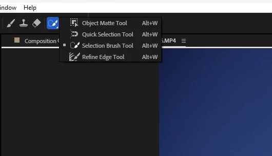

I mean you have thought it through and added not only the standard Object mask tracking but also a means to properly correct the mask. I mean these guys:

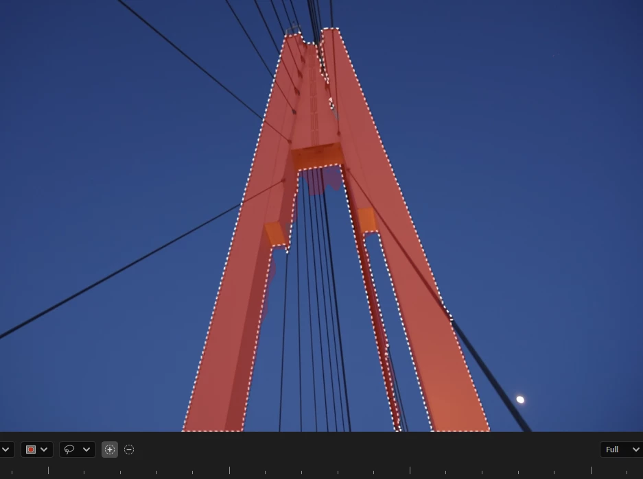

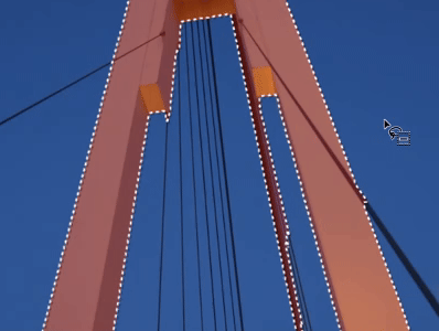

Here’s an example:
Premiere 26.2, Object mask selected the bridge stand AND the wires. Whatever you do next you will NEVER deselect the wire here:

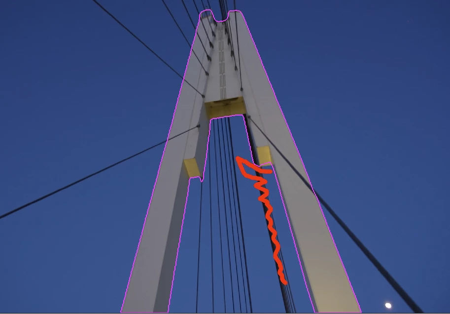

In after effects you have a selection brush tool which works as a brush and it does work in such situations - you draw a negative mask and the selection is gone:
So my feature request is adding at least the brush tool to Premiere. I’ve had a lot of situations when the Object mask failed to deselect the needed parts of the image and and I had to make a combination of several object, rectangular and drawn masks thus wasting a ton of precious time in a simple footage.
