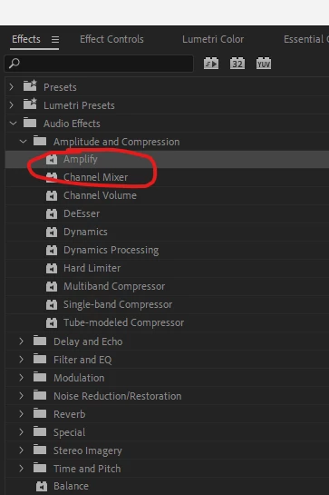

Richard, thanks for your suggestion.  Will this work as well as the audio gain dialog...

You could use the 'Amplify effect.
