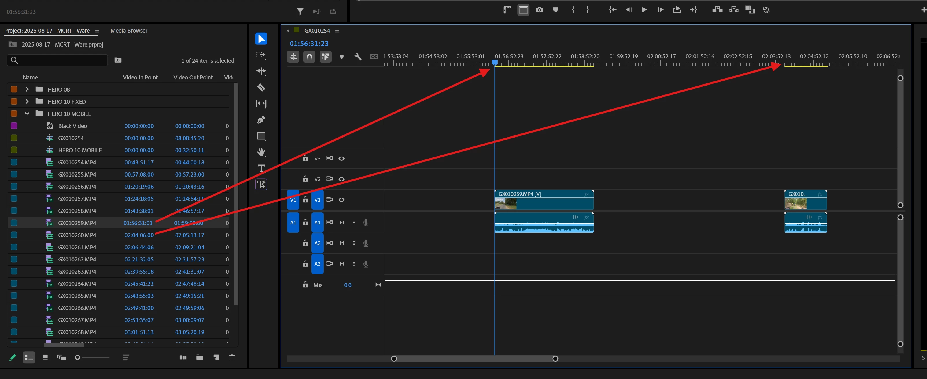

Goal: To line up multiple video clips on the timeline by putting them on the timeline at the timestamp that is showing in the Video In Point metadata - automatically.
Scenario: Three GoPro cameras, none of which the times matched, and audio is nothing but wind from riding a bike. One GoPro "Fixed Cam" is set to constant record, powered by a power bank it can record straight for about 10 hours. So there is a "reference" I am trying to line up here. The other two are turned on and off via a remote, and they move from facing rear, to chest mount, to helmet, to tripod, and so on.
The footage is coming back with a Video In Point and Video Out Point in the metadata, guessing that is based off the internal clock, as accurate as that can be. Right now I am dropping the footage from "Fixed Cam" onto the timeline and getting a 3 hour plus long clip.
I would like to automatically place these clips on the timeline at the points marked Video In Point. They may not line up with my reference footage from "Fixed Cam" but I will only have to move the whole track once, and they should line up pretty close. At least enough to nudge them forward or back.
Right now I am selecting the Video In for EACH clip, copy, going to the timeline, double clicking on the playhead numbers, paste, and the playhead moves to that spot, drag the clip over. I am looking at doing this a few hundred more times today, so looking to see if there is a way to move them to line up with that Video In metadata, or better, some kind of shortcut key to click on the clip, "magic keystroke or script" and the video gets placed on the timeline at that spot without me having to go find it.

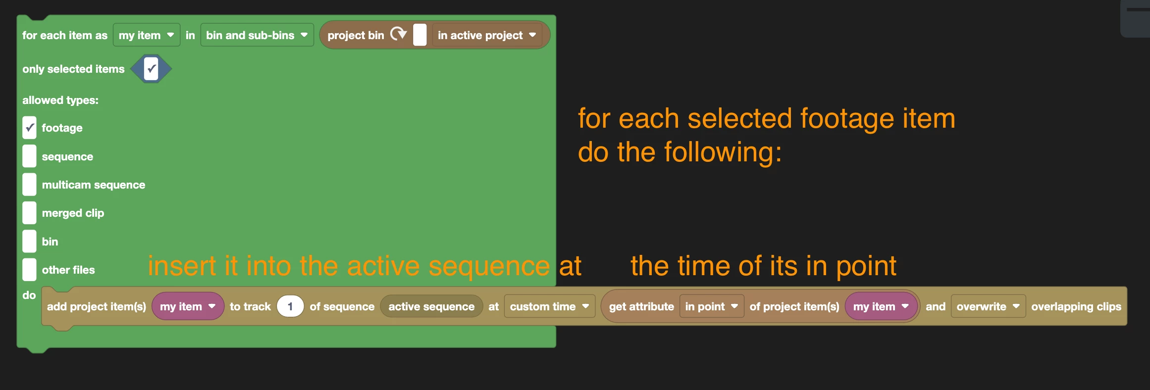

I just created this little script and added it to the Community Library of Automation Blocks:
Sequence/Populate/Insert Selected Clips Into Active Sequence at Their In Point.xml
Does this Automation Blocks tool do what you need?
To use it:
Just save the attached  xml file and load it into Automation Blocks for Pr (you can test it with the free trial).
The select all clips you want to insert and run the tool. It will insert them into the active sequence.
