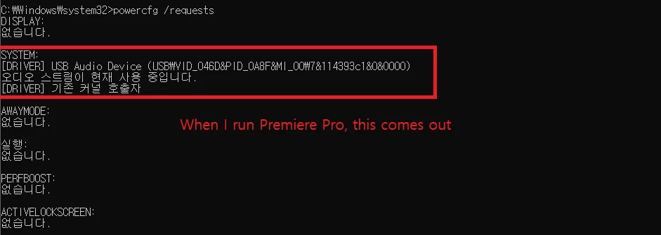

umanboyAuthor
Jan 4, 2023 11:58 AM UTC
MyerPj. You are superman.
Pr take input/output devices when initializing. It set up with my Logitec Headset.
And It read Headset attached microphone as default input device.
And I went to Edit-Preference-Audio/Hardware , make it then "No Input" in Pr.
all gone and now sleep mode works !
Thanks! It help me not only for this topic, but now I know how to use "powercfg command" in windows life.
Thanks again !

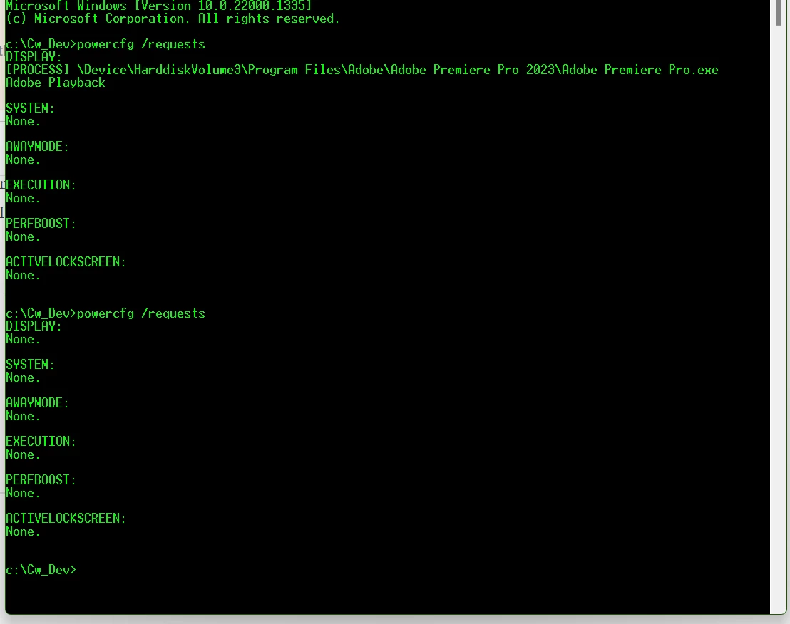

MyerPj
Jan 4, 2023 5:21 AM UTC
Yes, you have to hunt it down. It can be a pain. I just checked it again, and it won't sleep when PP is playing, so also rendering I take it. I just setup a power profile to shut monitors at 1 minute and sleep at 2 min, and use that for testing.
powercfg /requests, the top one is while PP is playing back, lower one was when I stopped the playback.

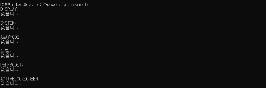

umanboyAuthor
Jan 4, 2023 4:52 AM UTC
OK, So Premiere Pro has no problem for sleep mode basically.
Then, I need to check what my PC to be awaken as you suggest
