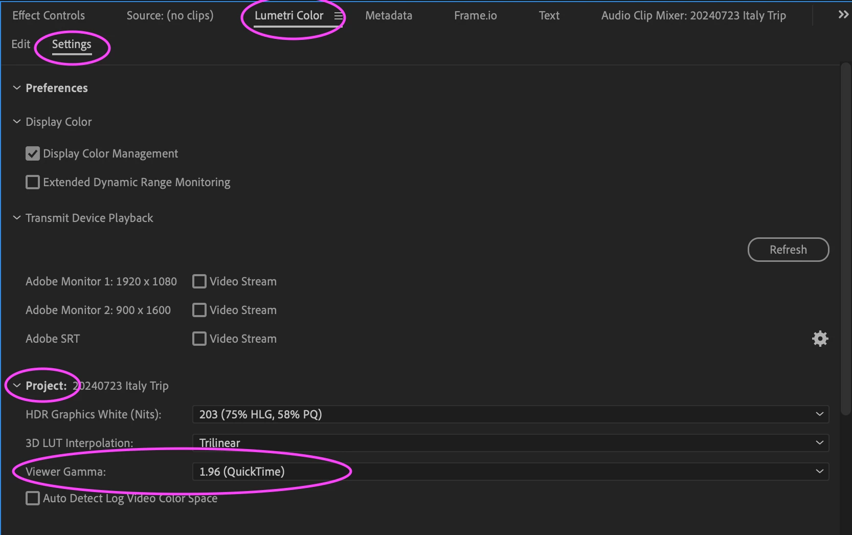

I made this video on how to correct the problem for make videos for phones, computers, etc (non broadcast). The setting you need to change is in Lumetri Color > Settings > Project > Viewer Gamma > Quicktime. Make that change and your colors in PP and in your h.264 export will be the same. https://youtu.be/QirnkZA0ZUY

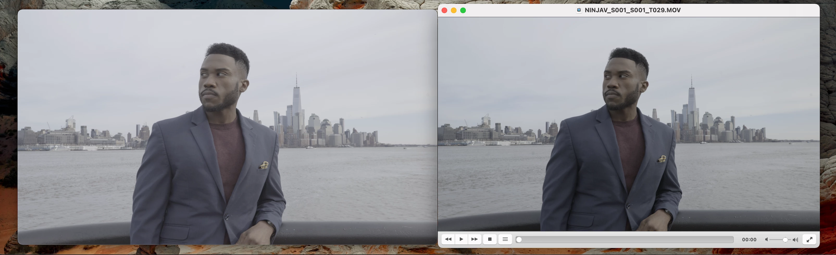

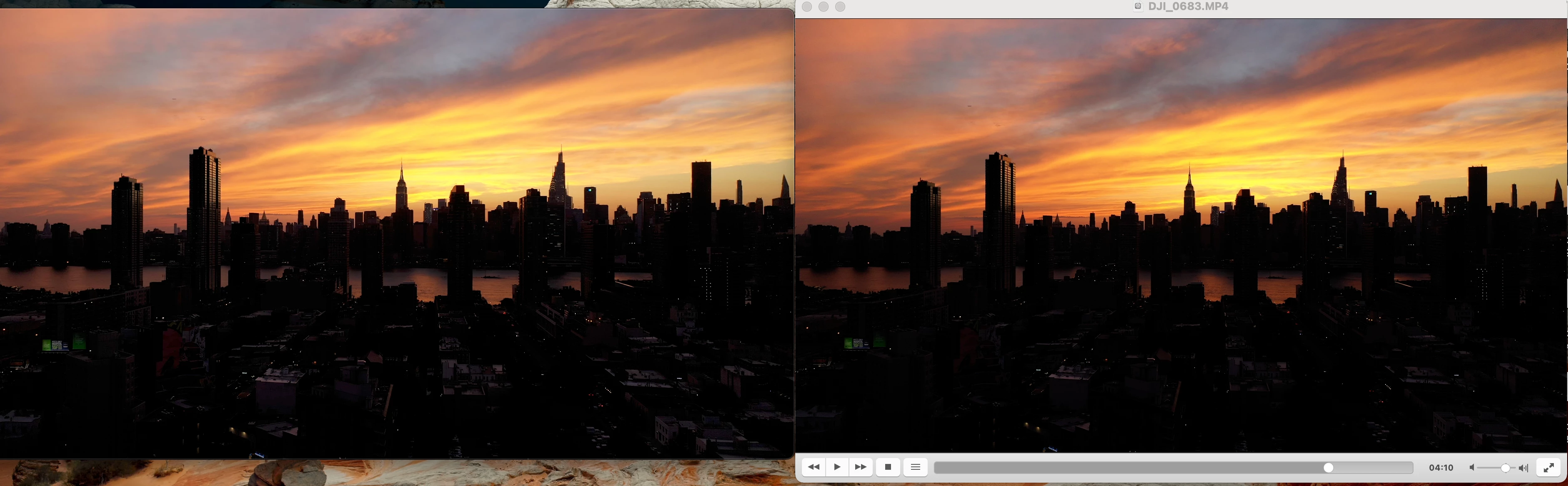

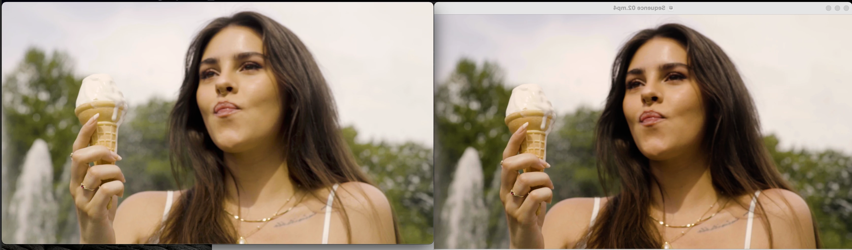

Thank you for explaining. I'll have to update my system so I can run Premiere 24 because those changes really sound worth it. I started viewing random video files on my mac and comparing them in Quicktime and VLC to see if theres any difference or if its just videos I've exported from Adobe software. To my surpirse its every single video, totally raw videos that were never imported or exported to Adobe. Every single video I watch has a different gamma in Quicktime vs VLC. So is that just because of Mac's Color Utlity controlling Quicktime? Its just crazy to me that the same file will never look the same between those two programs.
Some screenshots I took. QT on Left. VLC on Right.

In Pr 2024, you have a much easier color management setup in Premiere. Go to the Color Workspace, Lumetri panel, the Edit tab.
All CM options for the program are in the various sub-tabs. Including several new things, so you should look through it in general.
Especially for Macs in 2024 (though of good use for all users)
There's a new option for setting the Premiere display gamma. With three settings available, which will set the Program Monitor of Premiere to the gamma you select.
  • Broadcast 2.4 ... this is the general standard for professional Rec.709 deliveries worldwide.
  • Web 2.2 ... this is allowed in the standards for use with web-only deliveries.
  • QuickTime 1.96 ... this sets your in-Premiere display gamma to match the Mac  Colorsync gamma of 1.96.
And this is the pick your poison choice. Where do you want this to look "correct"?  As you can't have a file that looks good at "proper" gamma 2.4 and at Mac gamma 1.96
Adobe can't "solve" this, though they've given you choices now. BlackMagic can't solve this, they give you similar result choices. No colorist can solve this. Only Apple could 'solve' this for all users across platforms.
