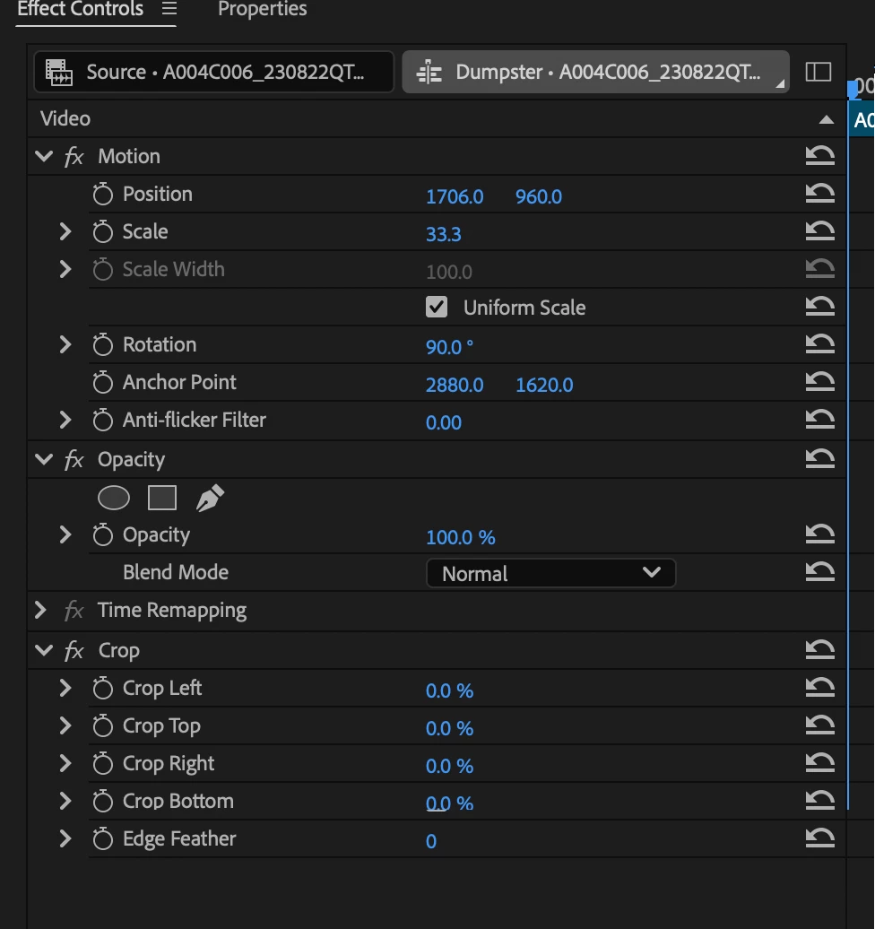

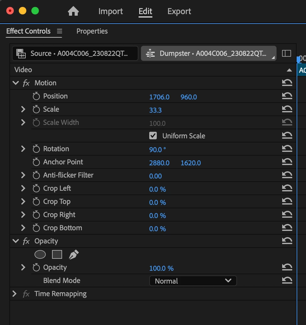

I really don't like how the crop effect was merged with "motion" in effect controls in V25. It's more an efficiency and quality of life thing, but there's so much more scrolling I'm having to do to get down to the effects I actually add to clips.
You can see in the screenshot I'm having to scroll down to make adjustments to my transform effect each time I need to change something. I know it doesn't seem like a big deal, but it's definitely noticeable to me.
I don't feel that crop is used enough to justify moving it here.
Thanks!

Crop takes up too much real estate in the effect controls list. it was fine as an add on where can minimize the whole effect into one line... this is so backwards

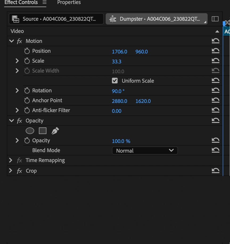

Thanks for the ideas. How about this: Create a twirly, and a default that it be twirled up. I'd be good with that.
FWIW, the old FCP had both Crop and Drop Shadow as intrinsic effects, twirled up and disabled by default. That was pretty cool and didn't take up space.
Cheers,
Kevin

I have no need for the crop effect as part of Motion either.
You cannot drop a shadow on the effect nor does it has feather.
I think the Properties panel is more than sufficient.
If it is here to stay please make it twirl up. Takes in too much room.

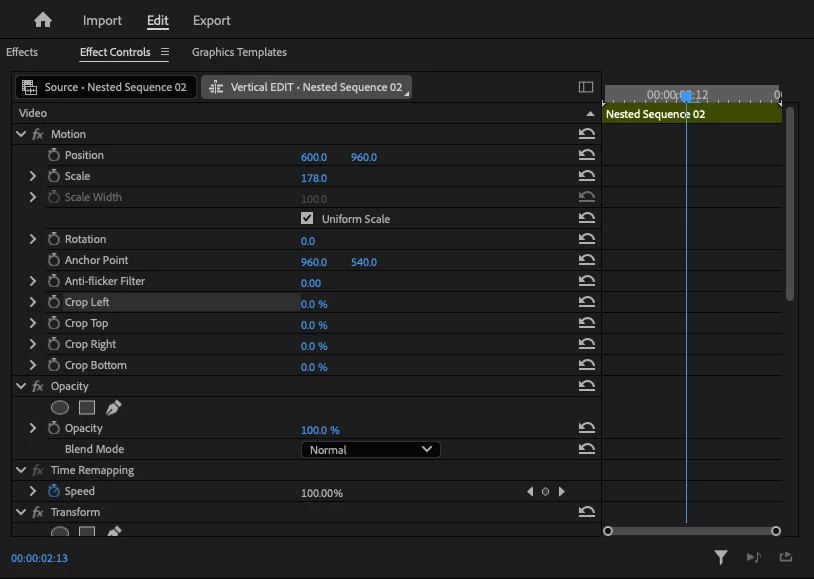

To reduce visual clutter, we suggest to group the individual Crop effects under the Effects Control panel so we can collapse it like Motion/Opacity. Also to include Feather parameter for the Crop group. Thanks
