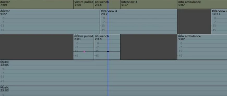

Idea is simple enough:
In the timeline it would be great to have the ability (like clip names) to toggle on/off the visual of the volume db on the clip. Similar to how avid media composer has it.

So it would show on the audio track what the volume dB level is per clip.
How does Media Composer handle such displays for volume graphed clips?

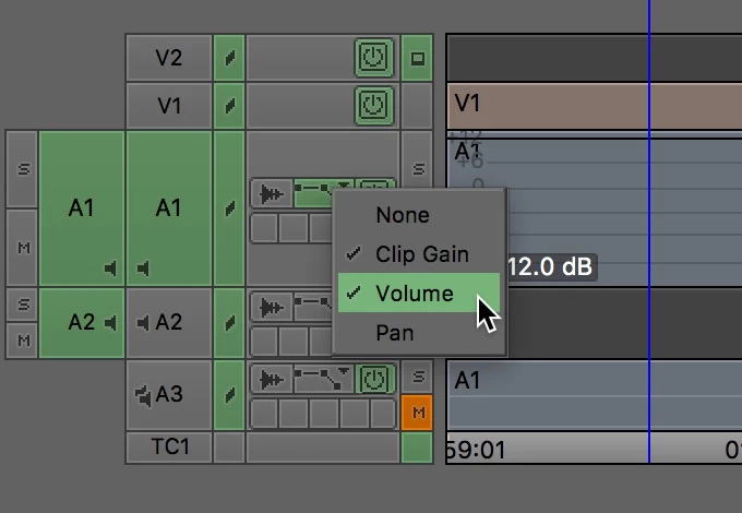

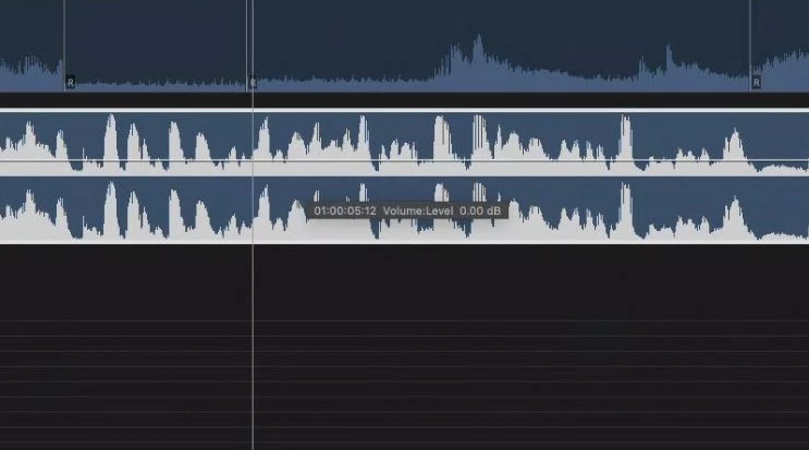

Jul 17, 2023 6:58 PM UTC
Right now I think the only way to show this is by either selecting the clip and going to effect controls, or hovering over the volume line like below.
