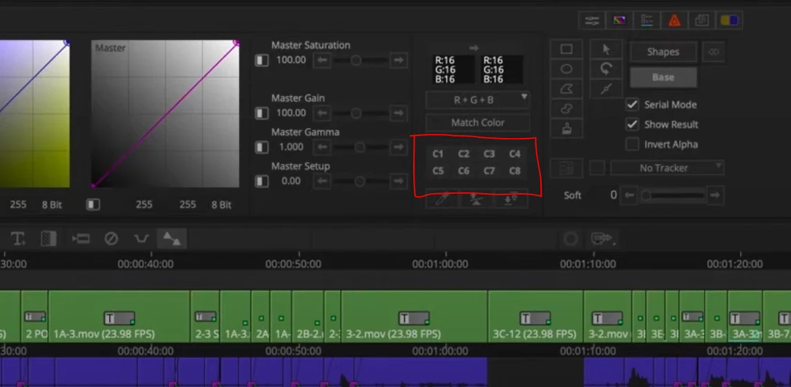

Here is another Idea from @Media Mogul17741148
Having been a colourist on Media Composer / Symphony in a previous life, I really miss the colour correction memories (pictured below). The way they work is that when you have graded your shot, you would hold down the ALT key and select one of the 8 memories. The next time you want to apply that grade, you just press that memory button to recall the grade. Such a time saver! In Premiere, doing a source clip grade can help with multicam edits. Toggling a LUT can help others. For the work I do with mismatched cameras on outdoor field shoots, a copy, paste, tweak workflow works best for me. Premiere allows you to save Lumetri effect presets to your effect panel, but I find this slows me down. I tend to find a similar shot from the same scene / camera / lighting condition and copy & paste that lumetri effect to use as my starting point. If Premiere would allow you to copy all of the lumetri effects on a clip (because often you have a few to correct different elements of the shot) and save them to Avid like clipboard memories... and if Tangent could let us map the memory saves and recalls to our conntrol surface buttons.... game changer.
