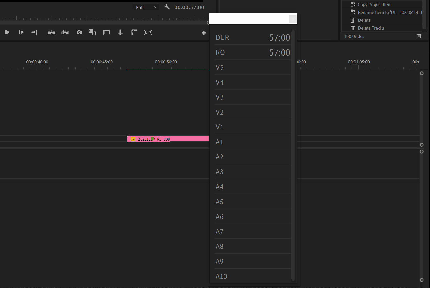

Jun 15, 2023 11:37 AM UTC
Sure, I have it docked next to my timeline. Just drag it by its "head" and snap it. And make sure to save the workspace so you don't have to repeat the process every time.

One quick question, is there a way to make this panel dockable? I'd happily have it as a permanent part of my layout.

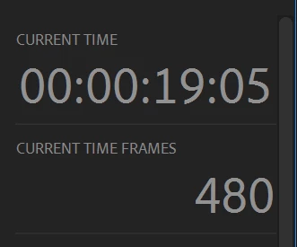

Jun 15, 2023 11:23 AM UTC
Go to Window > Timecode, this will open a small timecode panel which you can place where you can glance at it easily.
In the panel, you can add as many lines as you want (sequence, video, audio, duration, in/out, etc...) and you can choose the format you want. So you can add two sequence lines, one that displays the timecode in 25fps for example, and the other in frames.
Below is an example.
