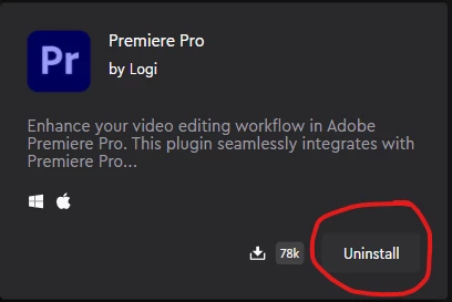

December 7, 2024
First Uninstall the "Premiere Pro By Logi"  Plugin From the MarketPlace in the Loupdeck application then close Premiere Pro and again install "Premiere Pro By Logi" that's done

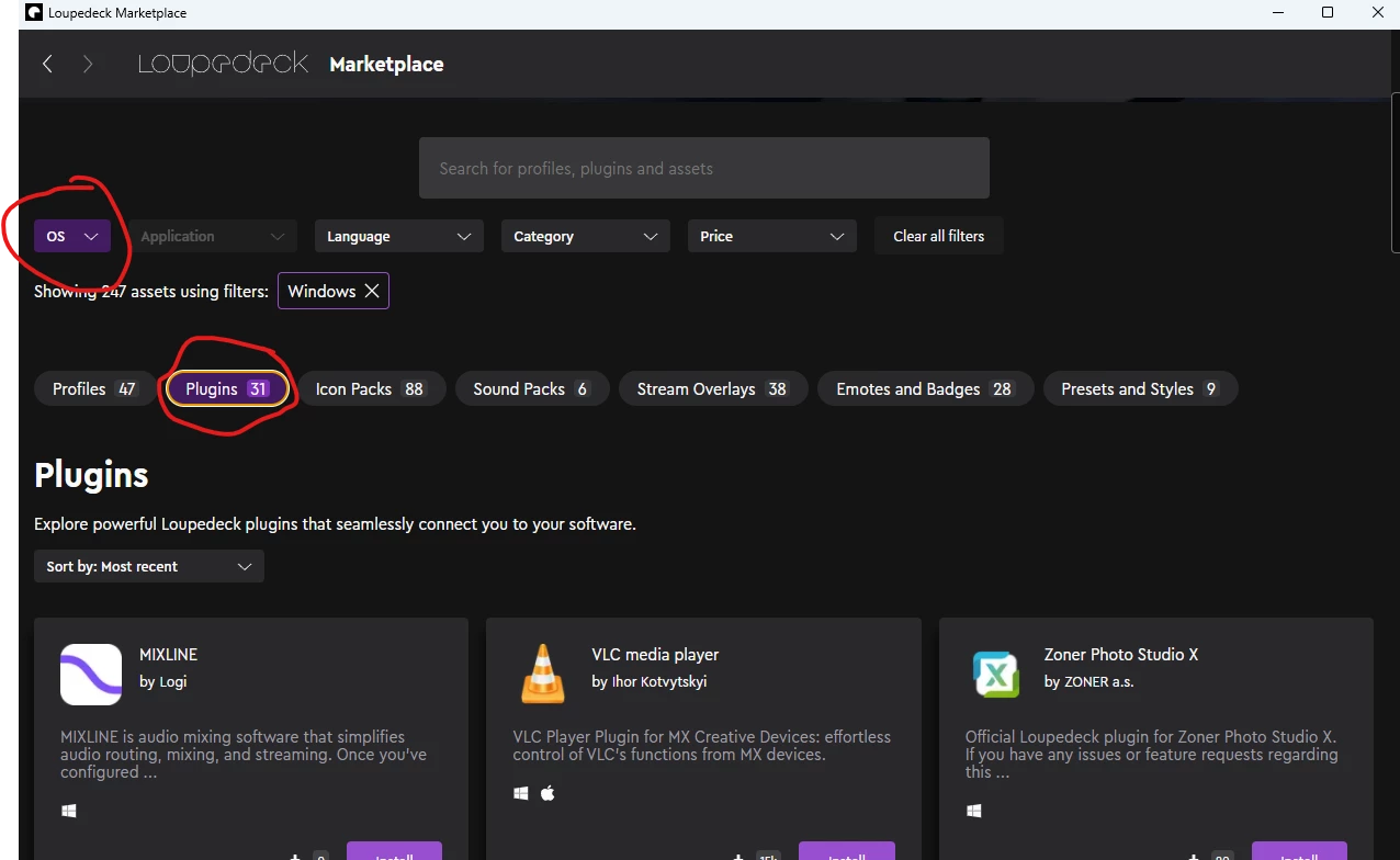

November 23, 2024
Installing " Premiere Pro by Logi " from the Loupedeck Market Place (accessed from within the app), works for Premiere Pro v25 , control surface will be available to select.

November 21, 2024
The Logi Plugin needs to be installed from the Loupedeck Market Place (accessed from within the app), and it needs to be installed/reinstalled after Premiere Pro is installed.
After that has been done, it works fine with PP v25 for me.
