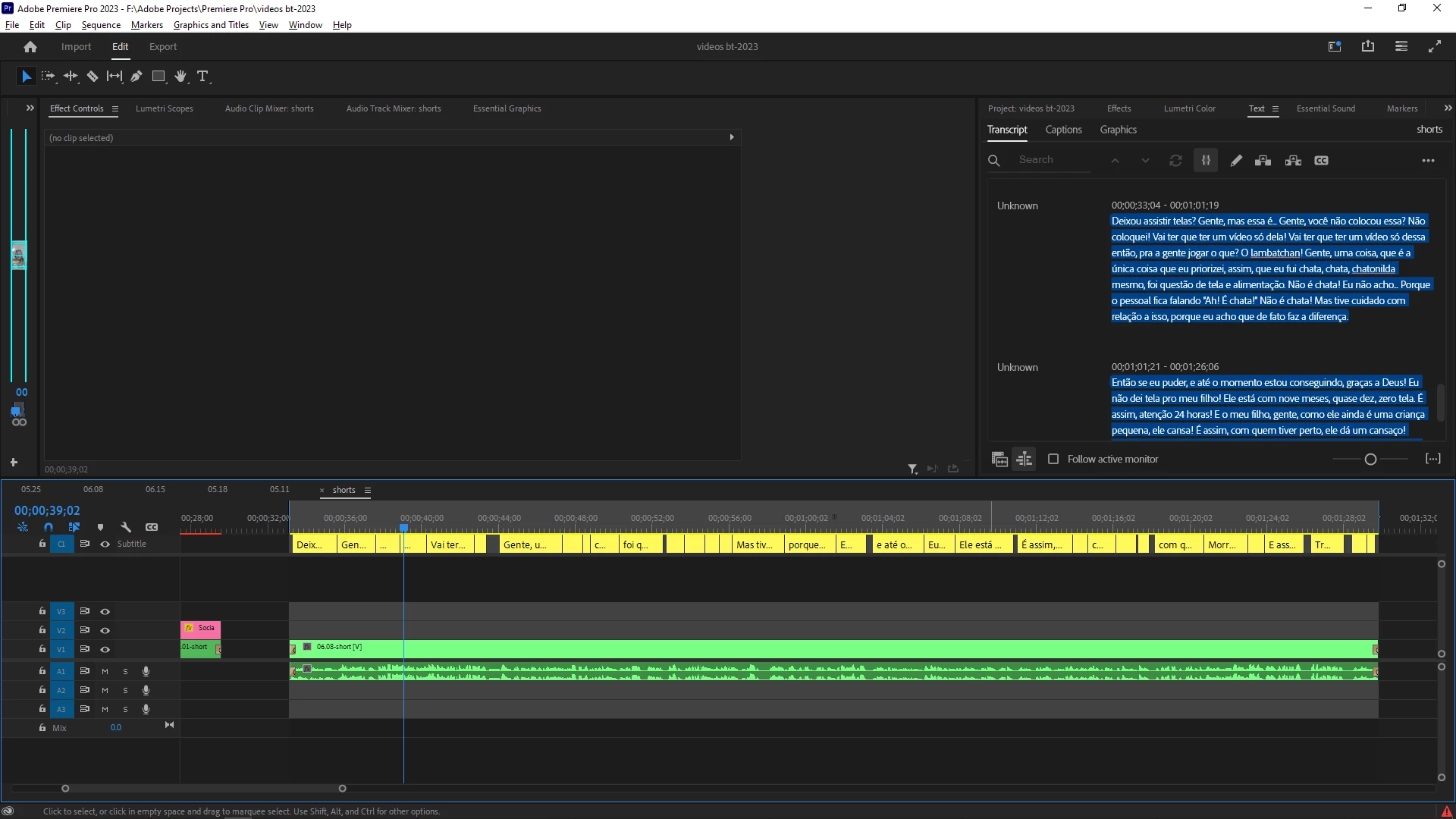

Hi! I'm Marcos, an Adobe user for many years already, and I have a complaint about a change you guys made on the Premiere Pro Transcription Tool. What happens is that the Transcription Tool, a couple weeks ago, was doing just fine. Actually, it was (and still is, even with all the headaches it's been giving me) a very important tool in my editing process. However, about a month ago, or maybe less, Adobe and its Product Managers decided to make a change to the tool that turned it into a real nightmare. The way they changed the transcribing part of it was not bad, but it's been making many more mistakes and the way you get to change the text itself, is just terrible. Not to mention that it's completely buggy. One transcription line for each little clip, even the ones that are from the SAME source, is just a dumb thing to be done. Also, many times it has happened to me that I click a transcription line to edit, I edit what I need, and when I finish editing it just does not compute the change I just made, which is VERY annoying. It was a very good, useful and functional tool that just became a headache.
My suggestion is just to change it so that it can be useful again. There is no need to bring it back to what it was, but just make it a good tool to be used again, please. I use this tool to transcribe videos for social media, and something I used to take less than 10 minutes, is taking me almost an hour.

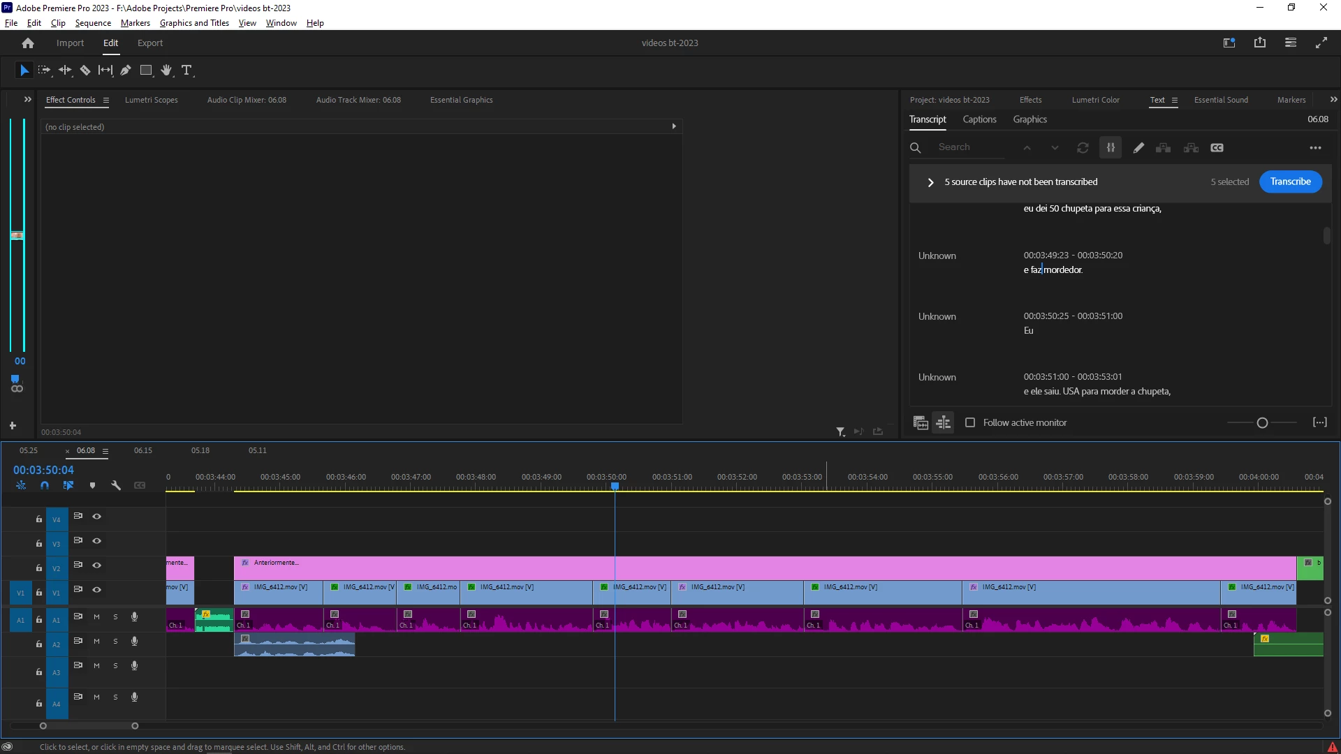

Jun 8, 2023 5:26 PM UTC
It happens in normal sequences. The second screenshot is a normal sequence, where I had the "problem", not a nested sequence, nor a subsequence. Anyway, thanks for pointing out the change on the static transcription option. Which I still think was a bad move, once that was the way Premiere used to transcribe texts, and now moving it behind a "hidden" option is not a good thing for the user experience. But once I have it cleared I hope I don't run into this issue again.

Jun 8, 2023 3:55 PM UTC
Hi Satn,
The problem is when you have a sequence that you want to transcribe that has a lot of cuts/clips. Because back then, it would show a big chunk of text that you could edit, that you can see in the first image. Now, when you have a lot of cuts, it shows the text between the cuts, even though Premiere knows where the cuts come from (basically, from the same source), and you can see it in the second image. So, when I'm editing a fast paced video for YouTube and other social media, it becomes a nightmare to use the tool because I have a ton of little text boxes to edit, like I showed in the picture I mentioned, that have only two or three words, which is just a very weird and annoying thing to happen. And no, I'm not using the source transcription option. What I ended up doing was render the part of the video I wanted to transcribe, import back to Premiere and then transcribing that.
