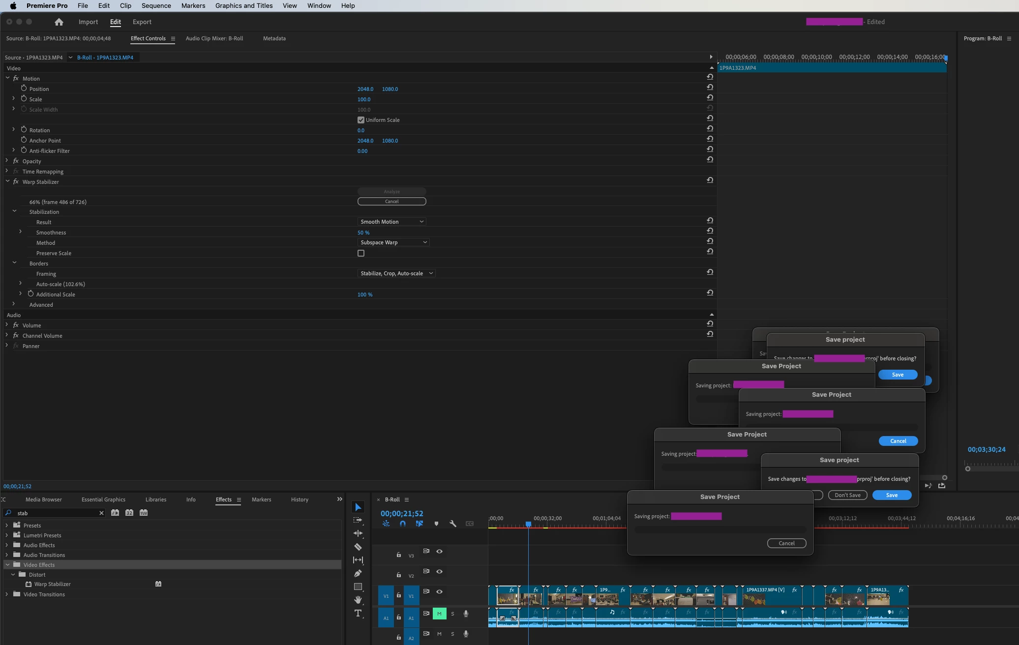

With a brand new M3 Max MacBook Pro, PP has locked up after trying to use warp stabilizer on a dozen clips (4K from Canon mirrorless).  It's simply choking and doing nothing, with no frames being analyzed and none of the timers going down.  Is the app not smart enough to analyze one clip after another and get it done?
Worse, I try to save the project, and the save dialog box just sits there. I can press cancel, and go back to editing, but the dialog box stays up on screen because the UI is borked.  I try to close out of PP and it asks then if I want to save, and I say yes, and then those dialog boxes are stuck on screen, without any saving happening.

Those permissions are set, and the project is able to save normally at all other times, but just borked with those stuck project save dialog boxes (as seen in the screenshot attachment) always coinciding with when PP is also in a state of being stuck supposedly processing WS on multiple clips (but in actuality, no frames are being analyzed or progressing on any of the clips).

What I get instead, though, is that multiple clips apparently fight for CPU time and attention, and none of them progress at all; meanwhile, PP completely freaks out, and can't even save the project file (see screenshot attachment in the orginal post). This seems broken/bugged to me.
