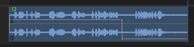

I had a memory of that one could just place a silent/muted audio clip or a piece of let´s say Black video/Adjustment layer at the end of the audio clip with the delay effect, so that the CTI continues to play though it has reached the end of the audio clip.
I have now tested that and realize that i am dead wrong and am unsure if that even was a working workaround back in the day, or not.
It is however possible to do like i did on the screen dump here. Two keyframes that mute the clip and at that point the echo continues and don´t stop abruptly. But, this requires that the audio clip has more audio so it will be unuseful in many/most situations.

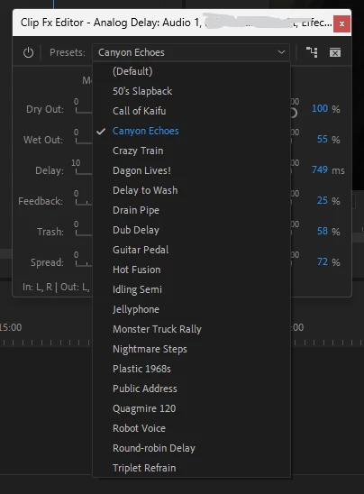

Just drop any of the three Delay effects from the Effects panel to the audio clip on the timeline. No need for nesting and/or adjustement layers.
