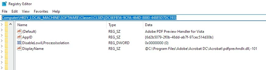

I have 64-bit Windows 10 with 32-bit Office 2016 installed. The 32-bit reader worked fine on this machine for years.  But after an automatic upgrade to 64-bit reader, the PDF preview in Outlook no longer works, says there is no PDF previewer installed.  Inspection of Outlook settings confirms no PDF previewer available. It seems the only solution is to revert to 32-bit reader, but I cannot find any way to do that.  The installer uses the 64-bit version because the OS is 64-bits.  Is there a way to force installation of the 32-bit reader on 64-bit Windows 10?

In Step 4 the registry is already set exactly as described.  But this entry is in WOW6432Node and pertains to the 32-bit Reader. The 64-bit Reader has setup the 64-bit registry entry as shown below.  I presume that 64-bit Outlook would find this and work correctly.
This problem is resolved by the solution in https://community.adobe.com/t5/acrobat-reader-discussions/pdf-preview-handler-missing-in-outlook-365-trust-center/td-p/12333908

I have inspected the registry and can see that Acrobat Reader is correctly setup as PDF previewer in 64-bit registry, but that is no use to 32-bit Outlook.  A 32-bit application cannot use a 64-bit DLL.  I should clarify that the 64-bit reader appears to be working fine in other regards, only the PDF Preview in Outlook is not working.  But that is a real drag!
