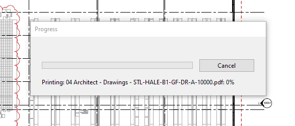

Hi All
When attempting to print architectural A0 layouts the program freezes and then crashes
The files are noormaly around 10mb + so are large files.
The program is slow to load the drawings anyway, and struggles to pan with a good refresh rate so if anyone has solutions for that as well it would be appreciated.
I've attached a photo showing the progress bar, after this if you click on the drawing it freezes and then needs to be force closed.
The only other thing to not is sometimes it progress to 'Flattening' and then crashes.
Any help would be appreciated.
Thanks
Amal.

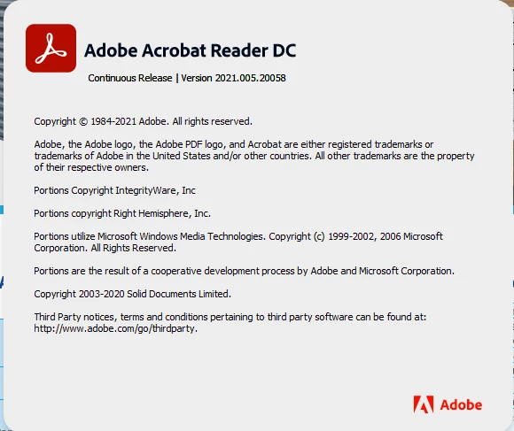

Jul 28, 2021 10:42 AM UTC
Hi Amal
This is the original psoter, I entered by email address incorectly and there doesn't seem to be any way to get that updated so just made a new account!
I've followed the steps and they do not seem to work, this is for large files failry consistantly as discribed in:
https://community.adobe.com/t5/acrobat/large-pdf-prints-from-adobe-pro-but-not-adobe-reader/m-p/9732393
The solution described in this post is a quick fix but  running a software package in a non-protected mode should not be a final soltuion due to the potential security risks.
The printer works, is fully updated and can print all smaller drawings, it can print these same drawing when imported to AutoCAD, again this is not a permanent solution as it takes time to import these larger drawings. I've tried from network and c drive locations.
My installation infoamtion can be foudn in attached picture.
Any help is appreciated.
Thanks
Toby
Amal.
