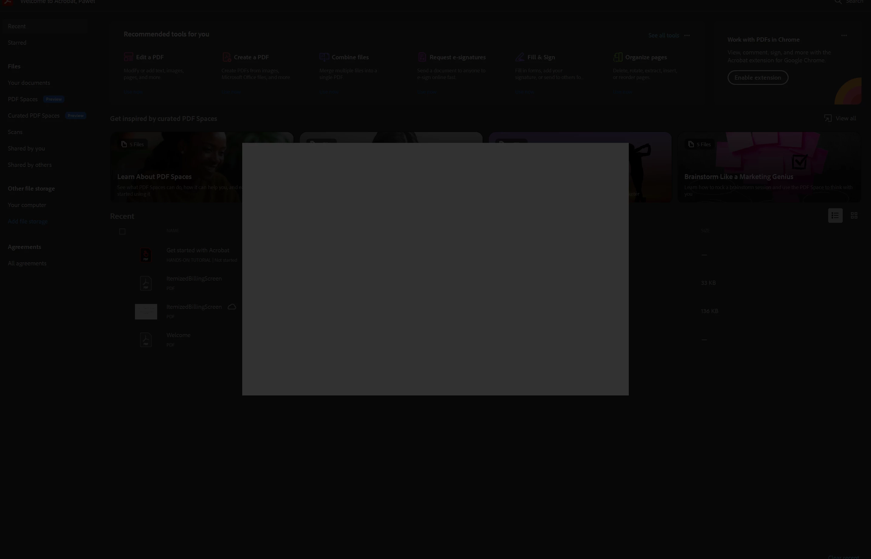

Gray overlay blocking Acrobat
When Acrobat Pro opens, within 10 seconds a darkened background and a blank gray modal dialog/overlay appears in the center of the screen. The dialog contains no text, buttons, loading icon, or close option, and it blocks all interaction with the application. I can still see the Acrobat interface dimmed behind it.
The only way to close Acrobat is through Task Manager. Restarting the computer, uninstalling and reinstalling Acrobat, and trying common keyboard shortcuts such as Esc, Alt+F4, Enter, and Alt+Space have not resolved the issue. The problem appears shortly after opening a PDF, or even just opening Acrobat without opening a specific PDF.

    22865830pl21
    Jun 12, 2026 8:54 AM UTC
    Update:
    I have done some further testing:
    • Created a new local Windows user account and tested Acrobat Pro there. The same issue occurred.
    • Deleted/renamed system-wide Adobe cache under C:\ProgramData\Adobe. No change.
    • Checked Event Viewer while starting Acrobat Pro and then force-closing it through Task Manager. I did not find any relevant Error messages.
    • Checked Task Manager / wait chain analysis, but found nothing useful.
    • Looked for possible overlay software. The only relevant item I found was NVIDIA Overlay via NVIDIA App. Turning NVIDIA Overlay off changed nothing.
    • For testing, I have had no other Adobe applications installed and Creative Cloud is not installed.
    • Uninstalled Acrobat pro and installed Adobe Acrobat Reader, which works normally. I was able to install Reader, sign in, open and load PDFs without any issue. The grey/blank overlay problem does not occur in Reader.
    For context, the issue first appeared after I dragged/dropped around 20 JPG (~1MB each) files into Acrobat Pro to convert/combine them into one PDF. Acrobat appeared to hang during that process, and I may have interrupted or cancelled it.
