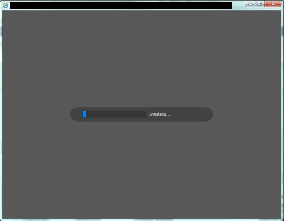

I'm working in a gov organization in Luxembourg. Our external and internal users report much higher than normal issues opening pdf files form internet explorer. Download progression is stuck (in the status bar) and the message "initializing..." is displayed.
First thing I tried was asking disabling protected mode for the zone the site is in, seems to work around this problem, but it is not ideal.
The problem seems to appear on ie11, on windows 7, latest reader DC update. (October 11).
Some users have it every time, some just once in a while.
Julien.
