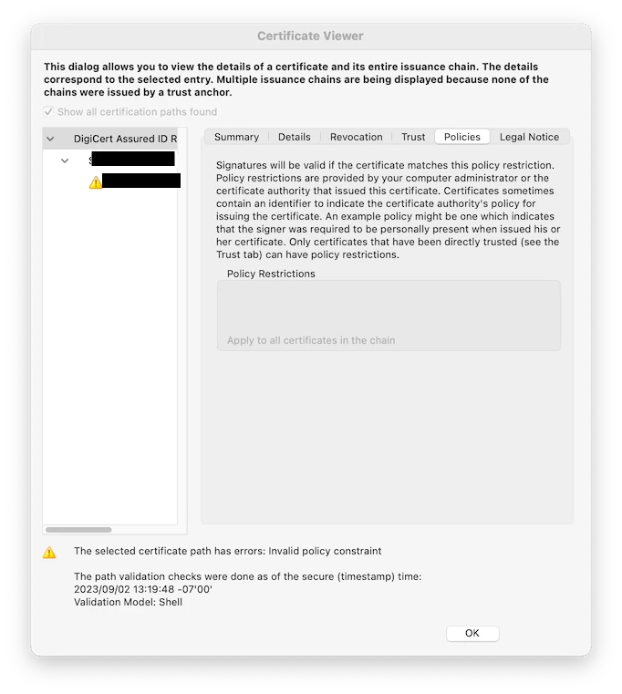

Reader's propertes of my signing certificate indicate "invalid policy constraint".

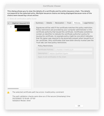

Reader's policies tab will sometimes show a grayed-out policy OID 2.16.840.1.114412.3.21 (Adobe Qualified Signer) on the root cert
[Hmmm.... I do not see 2.16.840.1.114412.3.21.2 which is indicated to be required for document signing per this document.)
and sometimes not show any, as though it is dependent on what was clicked on previously (Reader bug?)

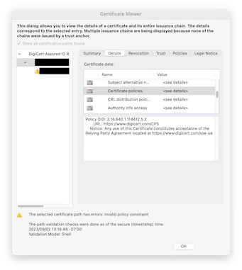

The policies tab for the company CA certificate and my certificate always show empty policies, but the company CA certificate has the policy OID 2.16.840.1.114412.5.2 (https://www.digicert.com/CPS).
