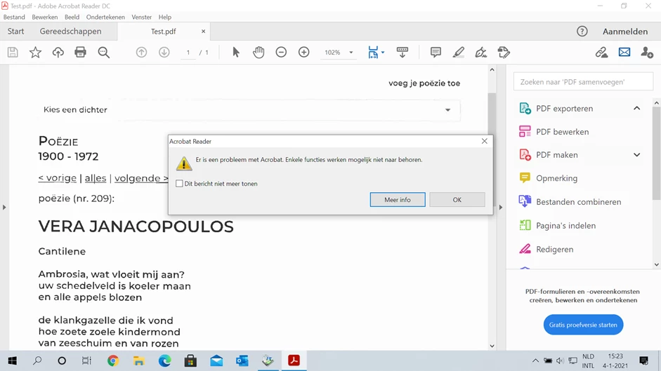

An acquaintance has a problem with the e-mail function in Adobe Reader.
He uses a scan application called Canon MP Navigator to scan a document to PDF.
The scanning works fine and after the scan is finished, the PDF-document is opened.
But the problem start when he wants to send the opened PDF-document by e-mail.
When he presses the e-mail button he gets the error: 'A problem occurred with Acrobat. Some functions might not work as expected' (Dutch: Er is een probleem met Acrobat. Enkele functies werken mogelijk niet naar behoren). (See attached screenshot)
The strange thing is, that if he closes the PDF-document and reopens the same PDF-document in Adobe Reader (from Windows Explorer), everything is working fine. So it seems there is something wrong with the process that receives a PDF-document from an external application.
When he presses the 'More info' (Dutch: Meer info) button, it opens the following page: https://helpx.adobe.com/acrobat/kb/acrocef-rdrcef-errors.html
I've tried all 4 solutions on that page, but none of them seems to solve the problem.
I've updated MP Navigator as well as Adobe Reader on his PC to be sure it's not a version incompatibility, but it didn't help.
I've also completely removed both applications and reinstalled them, it didn't help.
I've also disabled the virusscanner (F-secure) he was using, to be sure it was not a problem with a blocking application, but this didn't help either.
Does anyone recognize this problem and has a solution for it?

Hi Ruud,
We are experiencing the same issue. Maybe you can remember what the solution for this issue was?
I tried also all the options which you tried.
Thanks1

Well, I never found the solution myself, but he mailed me around a half year later that he found a solution himself by running the compatibility troubleshooter on the adobe exe, what solved the problem.
So if your right click on the adobe exe => properties => Tab 'Compatibility' => Button 'Run compatibility troubleshooter'.
That troubleshooter solved his problem.
Unfortunately, I don't have more details. I only speak him when he has pc problems 😉

I fogot to mention that we also reinstalled MS Office as suggested in this topic:
https://community.adobe.com/t5/acrobat-reader/attach-to-e-mail-does-not-work/td-p/9664914?page=1
But this also didn't solve the problem.
