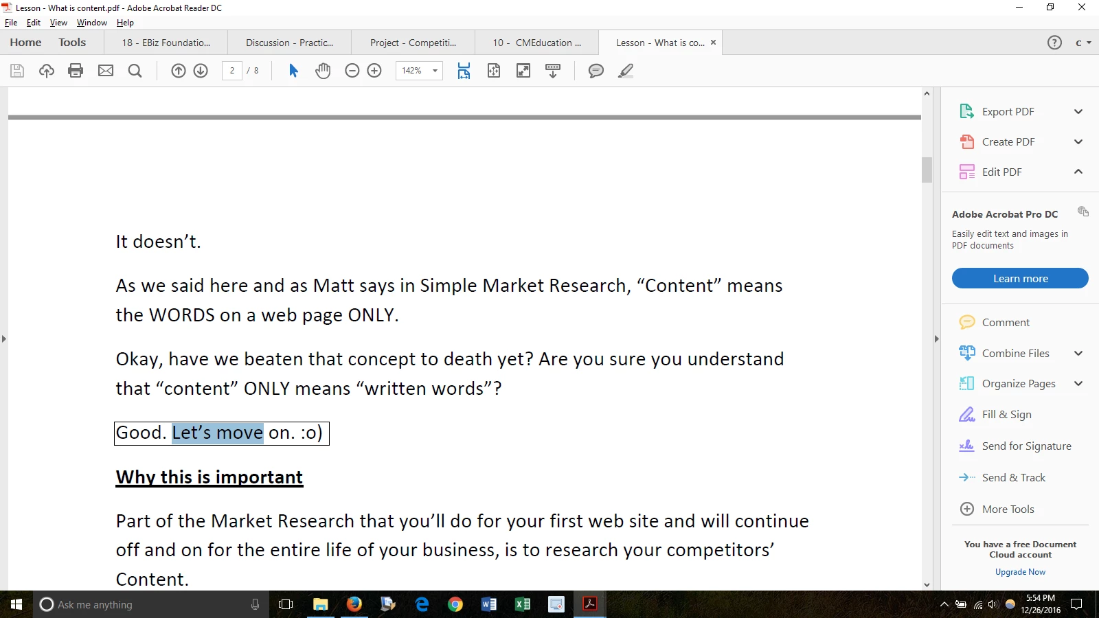

Thanks for your reply!  Yes, I'm able to select the text on the page.  I have attached what selecting the text looks like:
I'm having this problem in ALL PDFs, not particular ones.

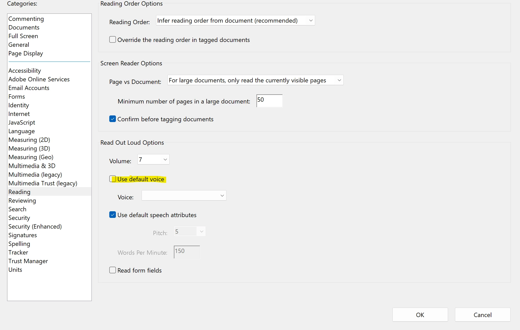

Feb 10, 2018 5:20 AM UTC
  1. Go to the Preferences dialog box of Acrobat Reader by selecting Edit > Preferences.
  2. In the left pane, select Reading.
  3. In the right pane, deselect the Use Default Voice and select a voice from the drop-down list that you have verified installed on your computer.
  4. Click OK.

Apr 16, 2018 1:55 AM UTC
Changing to Zira - Security enhancements still enabled worked.
David's voice does not work
