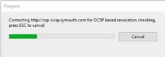

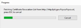

I am not certain what to name this error, so I haven't been able to find an answer through various searches, but when trying to open two documents each with a single digital signature, I get the messages seen in the attached images.  Then there will be an overlayed message (in the bottom right) indicating that Reader is verifying the signatures with a progress bar that doesn't move and Reader will freeze.  I have tried this on two other computers with Reader installed and they both instantly open the files and verify the signatures almost immediately.

Ran repair, restart - no change
Reset preferences, restart - no change
Enhanced security changes, restart - no change
Tested alternate profile - no changes
Uninstalled, ran Acroclean Tool, restart, reinstalling to test if there is any change (this tool leaves a lot of files an folders behind for something that is supposedly removing the software completely)
One thing I've noticed is that on this particular computer is that the downloader takes a long time to start and finish the download and install.  I'm wondering if it is having some issue establishing connections to the Adobe servers and maybe this is related to the issues validating signatures.
My next step was to try the Acrobat Reader and Process Monitor tool to see if I could catch any more detail on the error(s).

Dec 16, 2020 7:15 AM UTC
Hi Michael
Hope you are doing well and sorry for the trouble. As described you are getting the error indicating that Reader is verifying the signatures with a progress bar that doesn't move and Reader will freeze.
Would you mind sharing the version of the Adobe Acrobat Reader DC you are using? To check the version go to help > about Acrobat and make sure you have the latest version installed. Go to Help > Check for updates.
Its it still doesn't work, please try to repair the installation (Windows Only) from the Help menu and reboot the computer once
If it still doesn't work, please try to reset the preferences to default as described in the help page https://community.adobe.com/t5/acrobat/how-to-reset-acrobat-preference-settings-to-default/td-p/4792082?page=1
If it still doesn't work, please try to turn off the protected mode for testing (Windows Only) Go to Edit > Preferences > Enhanced Security > Uncheck 'Enable protected mode at startup' , Turn off the protected mode and uncheck enhanced security > Click OK and reboot the computer once.

Dec 16, 2020 11:57 PM UTC
Hi Amal,
Thank you for the suggestions.  I have been using the latest version of Reader DC downloaded directly from Adobe's site (2020.013.20074).  I had uninstalled Reader completely and reinstalled it with a fresh installer twice during this process, but that did not change the behavior.  Uninstalling also did not completely remove it as I found the Adobe updater was still installed.  I was planning to the use the Adobe Acrocleaner tool next to try and scour the software from the machine.  I will try the repair first.
