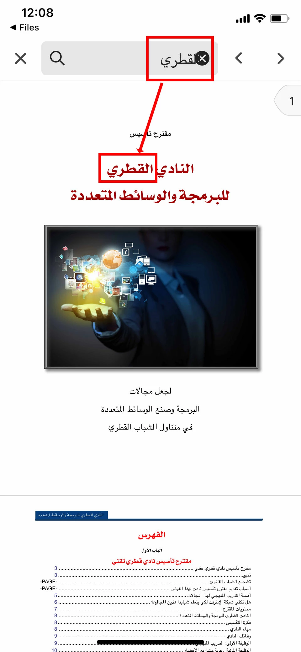

I just made a test to verify whether searching Arabic content in the a PDF works on iPhone or not. I can confirm what @mattai313 mentioned is accurate.
Here, I searched for the word القطري on the first page of the document using Acrobat Pro on my iPhone, Acrobat failed to highlight the word or jump to whereabouts that word exists on the document.
I switched the keyboard input Language to English, I searched for number "6", Acrobat jumped to the Table of Content, it highlighted the numeral "6" in a pink colour.
Here is a video where I searched for the word القطري, you can see Acrobat didn't act and didn't search even. At the end of the video clip, I double-tapped the word القطري manually to highlight it and show you that it exists on the PDF.
Note. I tested this same PDF document on my Mac using Acrobat Pro, the behaviour is as expected, Acrobat was able to find all instances of that Arabic word.
