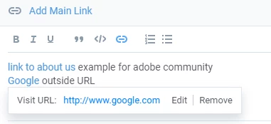

Internal links in PFD dont work.
Generate hyerlink from URL is set to on. URLto www.idontwannagohere.com  works perfectly !
But my point is that INTERNAL links dont work so to jump to page 50 and line 24
Is it blocked by system ? Because the original software that is exporting to PDF makes such hyperlinks blue ! so it noticed it but I cant click them to jump inside pdf to desired location, why ?
How to solve it ?

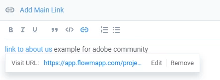

Nov 18, 2021 9:39 AM UTC
both are working in application ....
adobe export dialogue
is missing the URL link recognition, it is part of aplication.
The link is not in the PDF nor outside URL nor inside referal link.
Both are thou blue and therfore recognized by PDF algorythm as hyperlinks.
Any hints where the problem may occure ?
In online pdf preview the external URL works, referal document link does not.

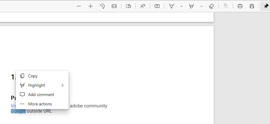

After export neither of them work.

Nov 18, 2021 10:11 AM UTC
Thanks for providing the details, we have checked the file it looks like that on this you have made the color blue but the link is not added. The application recognizes the link but if the links are in https://xyz.com format.
As the third screenshot shows that you are working on a desktop so this link would be helpful to guide you on how you create links to internal pages.
https://helpx.adobe.com/acrobat/using/links-attachments-pdfs.html
Let us know if that helps.
