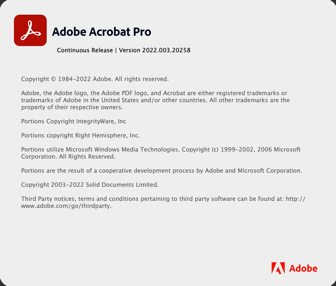

So, the issue must be with my version of Adobe Acrobat, or at some point in the pipeline from Adobe Acrobat to PDF Viewer something seems to go wrong. I have attached screenshots from the "about" of Adobe Acrobat, and hope to hear back from the support again as well.
