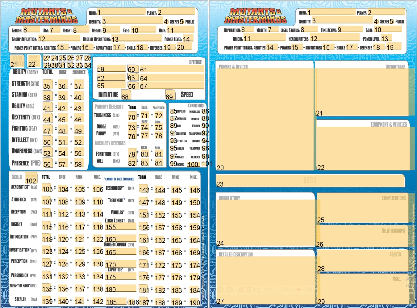

The project I'm working on may seem frivolous, but it's a very valuable and practical learning activity for me. I'm currently making a custom Character Sheet for a Tabletop RPG. I have all the other fields functioning precisely as desired; but they're all simple addition or cloning of values from other text fields.
So here's the situation:
I have 12 check boxes; they represent damage penalties accrued by the player. Ideally each of these checkboxes would subtract one (-1) from the "Toughness" text field's current value when they are selected.
They are all uniquely identified: "injury1" "injury2" etc through "injury12"
The text field is "defense_toughness_total" if I can figure out how to get "injury1" to subtract one (-1) from "defense_toughness_total" when it's selected (checked, active) I should be golden from there.
