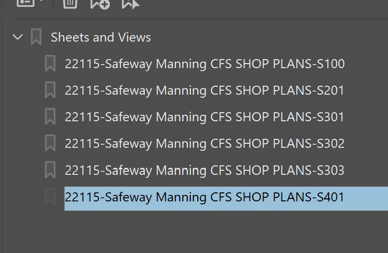

descentfan1975
Sep 23, 2022 1:43 AM UTC
I know this is an old question, but I have a similar issue. I want to strip out parts of all the bookmarks. See the attached file....I want to remove the "22115-Safeway Manning CFS SHOP PLANS-" from every bookmark and just keep the S101, S201, etc.
