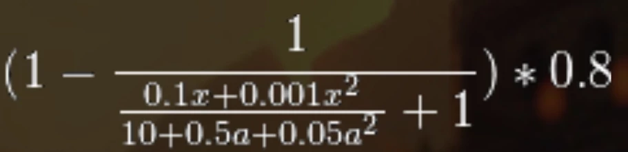

I was trying to separate fractions because if i use / it works even worse.
Use this:
var x = Number(this.getField("Rating").value);
var x2 = Math.pow(x, 2);
var al = Number(this.getField("AreaLevel").value);
var al2 = Math.pow(al, 2);
var hf = (.1*x)+(.001*x2);
var lf = 10+(.5*al)+(.05*al2);
var f = (hf/lf)+1;
var f1 = (1/f);
event.value = (1-f1)*.8;
EDIT: if you want it  to be more precise use this:
var f = (hf/lf)+1;
var f1 = (1/f);
if(al<15){
event.value = (1-f1)*.797;
}else if(al<27){
event.value = (1-f1)*.787;
}else if(al<34){
event.value = (1-f1)*.775;
}else if(al<43){
event.value = (1-f1)*.767;
}else if(al<48){
event.value = (1-f1)*.758;
}else if(al<60){
event.value = (1-f1)*.749;

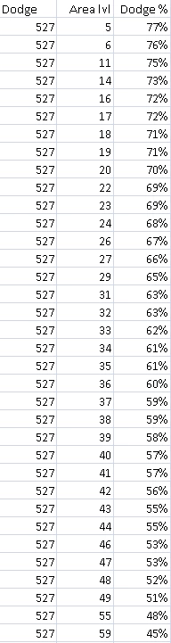

Hi, guys I still need help with this one, I was trying to figure it out but I'm stuck how to get this into code.
field1 is dodge rating and field2 is area level
and in field3 should be calculated percentage.
I'v gathered some info on the net so hopefully some1 can help me pls.
this is info i got so far:
calculator: https://www.desmos.com/calculator/b7s5aqep3b
original info: https://lastepoch.gamepedia.com/Dodge
and here are some examples:
Thanks in advance 🙂
