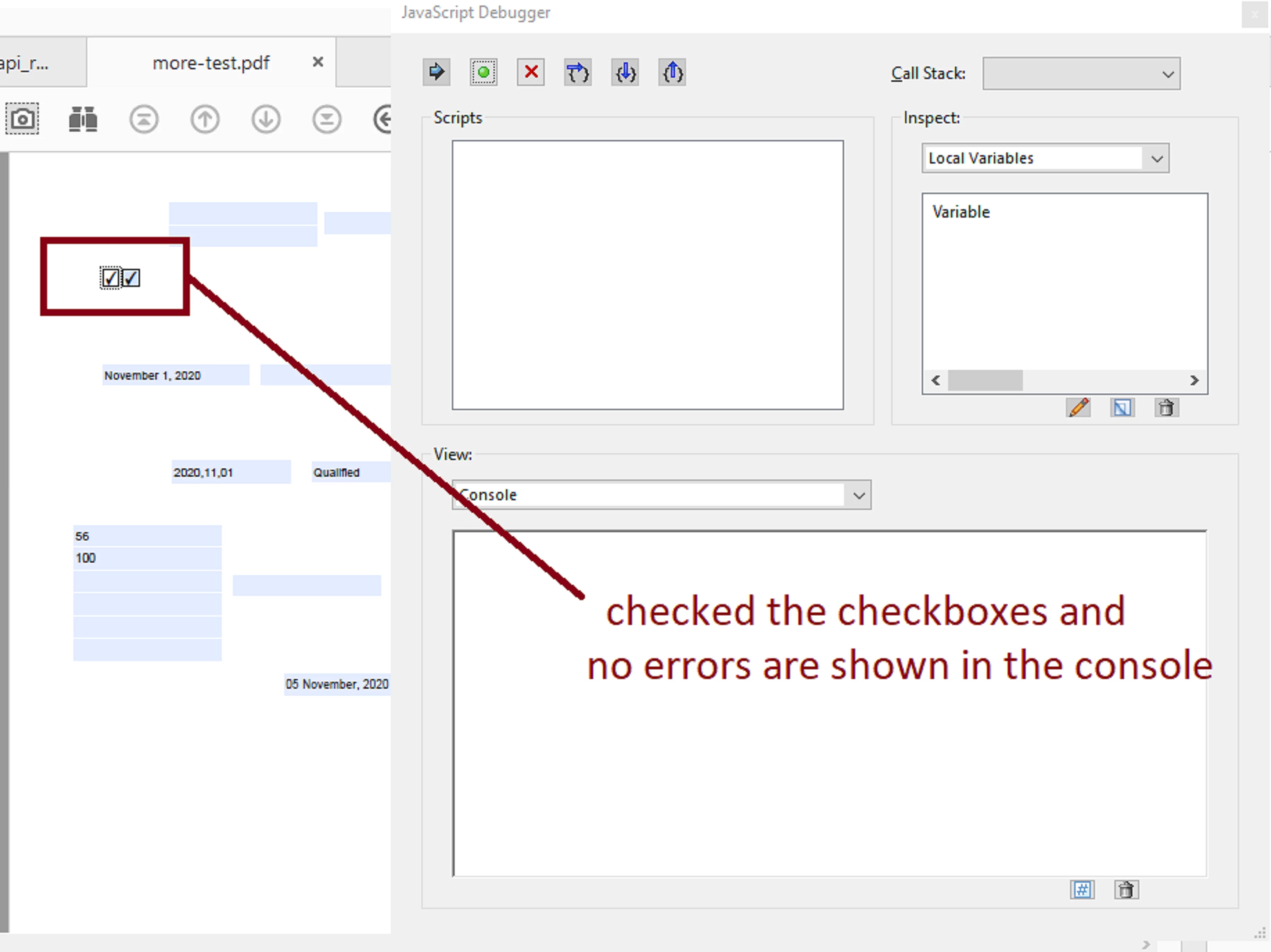

I closed Acrobat and restarted it.
I don't see where this script doesn't work.
  • First slide, boxes are checked with the console opened:

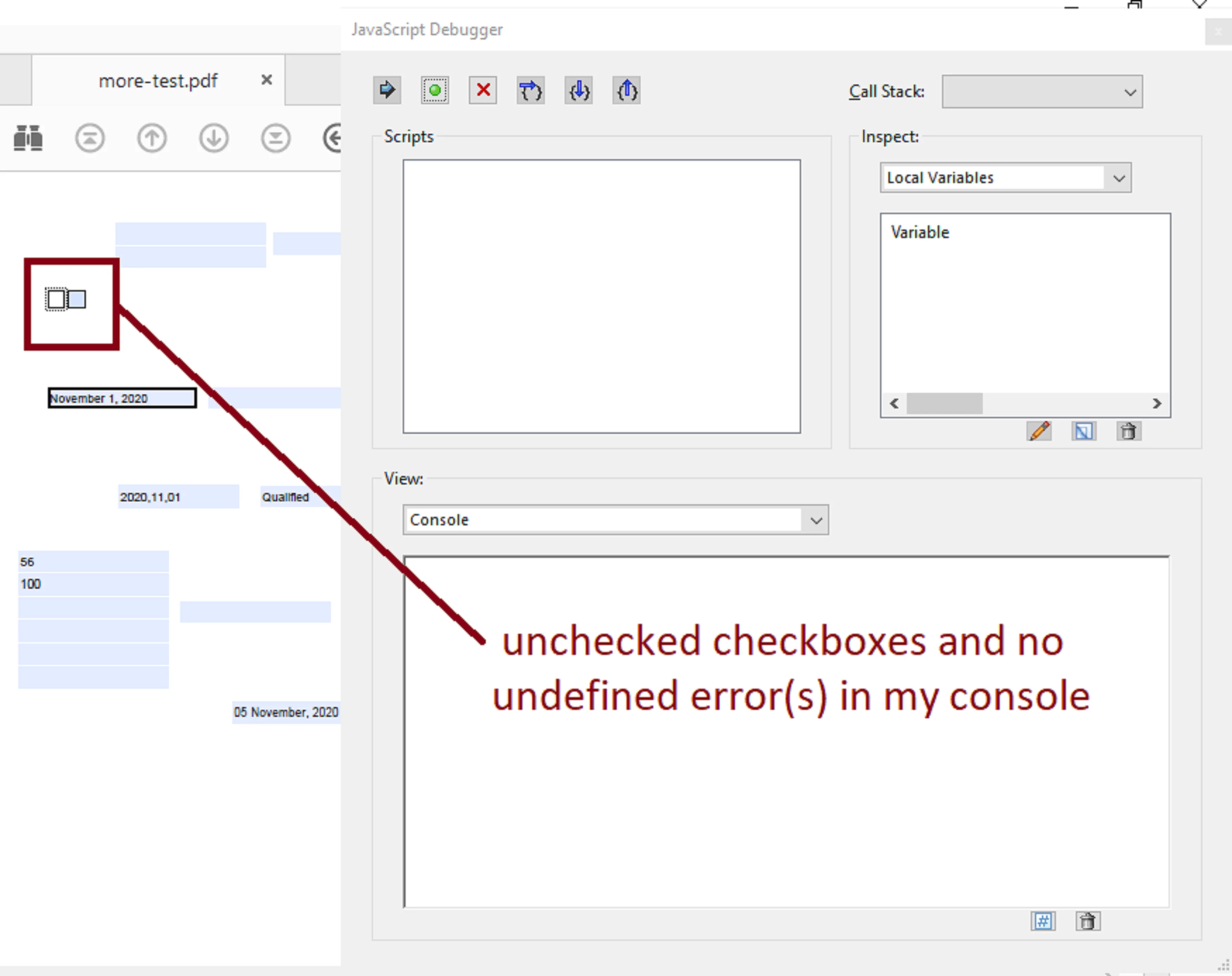

  • Second slide, boxes are unchecked with the console opened:
Now I'm confused... should I be getting an undefined error?

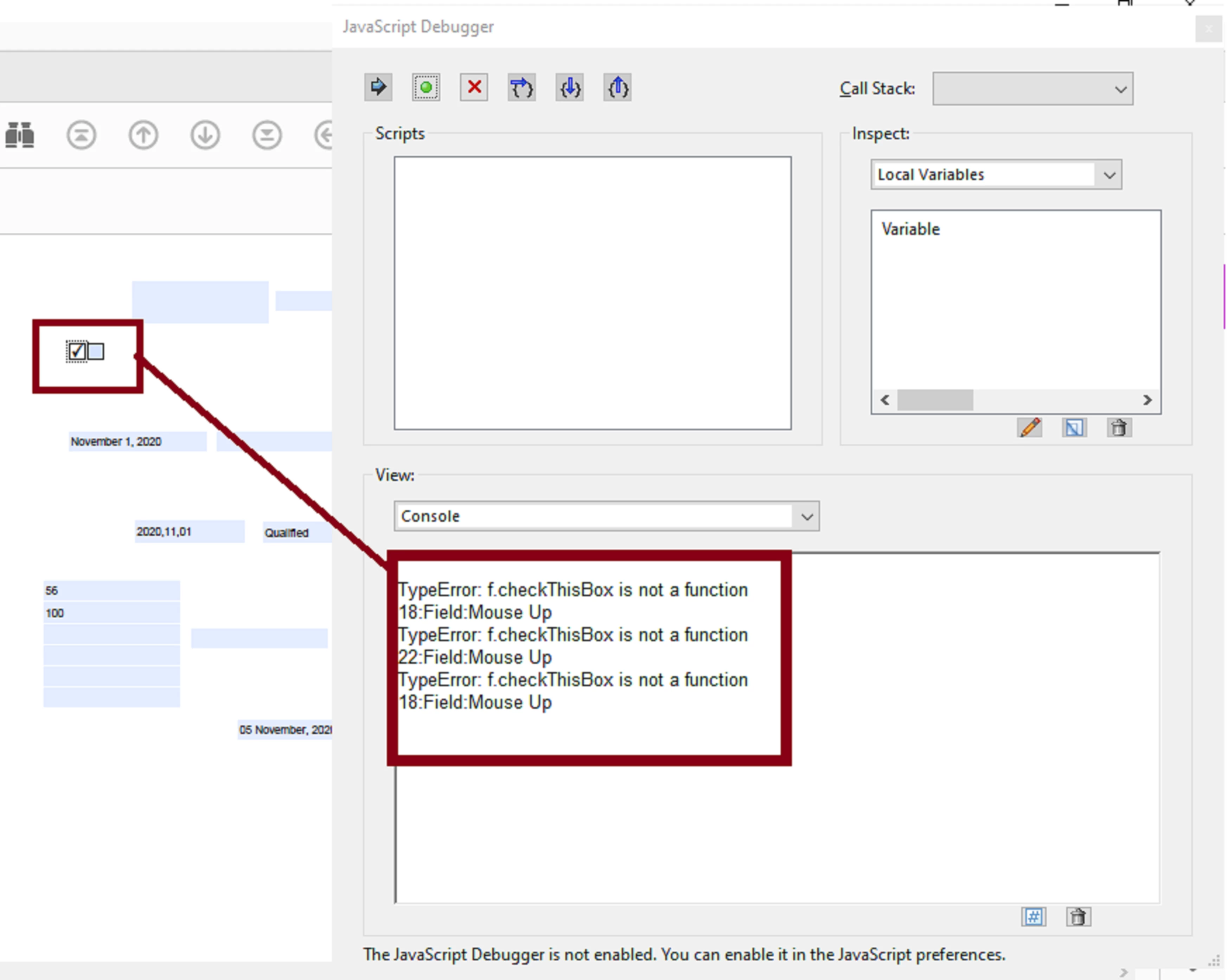

In any case I would expect a syntax error which actually happens when I add ".value" to the variable as you suggest:
var f = this.getField("200Plus").value;
In fact, I get a "Type Error" with your suggestion:
Also note that this breaks the original intent of the script as requested by the OP since the primary checkbox looses the ability to check the secondary checkbox.
