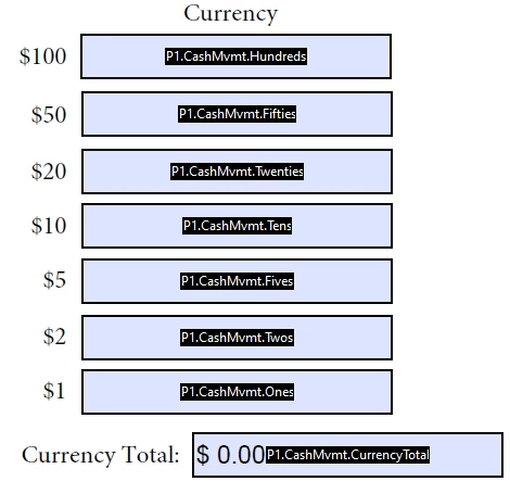

I am having a difficult time calculating the total of multiple fields and having that total display in the total field. The form I am working on has the ability to spawn a new page as well, the image below is a spawned page.
I've tried using the following code as a custom calculation but no matter what I do the CurrencyTotal field remains blank.

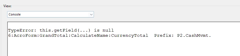

This is what is returning:
With the "this.getField(...) is null" error meaning a field doesn't exist, how do I determine which field it's referring to?
The null error is happening in a different script than the println. We know this because exceptions exit the script.
The only way to know for sure which field name is returning null is to place "console.println" code before the line where the exception is thrown.
It looks like it is the "GrandTotal" field contains the script that is causing the exception.
The fact that this field is throwing the error before the "CurrencyTotal" field prints the report, means that your calculations are out of order.
But thats a different issue, and for debug purposes you should remove the GrandTotal script entirely.
So it looks like the "P2.CashMvmt.CurrencyTotal"  calculation is working, or at least it's not thowing an error.
However, the printout from the console.println is slightly disturbing. Because if  "event.targetName" was split to get the prefix shown, then it should have printed out like this:
Name:P2.CashMvmt.CurrencyTotal  Prefix: CashMvmt.CurrencyTotal
I would suggest simplifying the form until the scripting is worked out. To do this, make a copy of the PDF, and then delete everything except for one of the total fields, and all the inputs that are necessary for that total.
