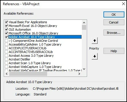

Hello, I am having some issues with a VBA script. I am fairly new to this so there may be some issues I don't see.
My main issue right now is that the forms are being filled but the save function is not working. I can see the forms are being filled but closed without saving. ultimately leaving me with blank forms.
I downloaded and installed the SDK as per the page I found but maybe I don't have the right ones enabled or installed.
Also my script is a mishmash of a ton of other threads I've found online so maybe its faulty from its base level.
Thanks in advance!

To start with, check and report the return value from PDDoc.Save. Also put a message if the Open fails. You shouldn't need to guess which line is failing. Also display filenm to check it is what you expect.
BarlaeDC
Mar 28, 2022 1:55 PM UTC
Has the PDF been saved before to that specific location?
CAn you try using the PDSaveFull option to see if that has any more success.
