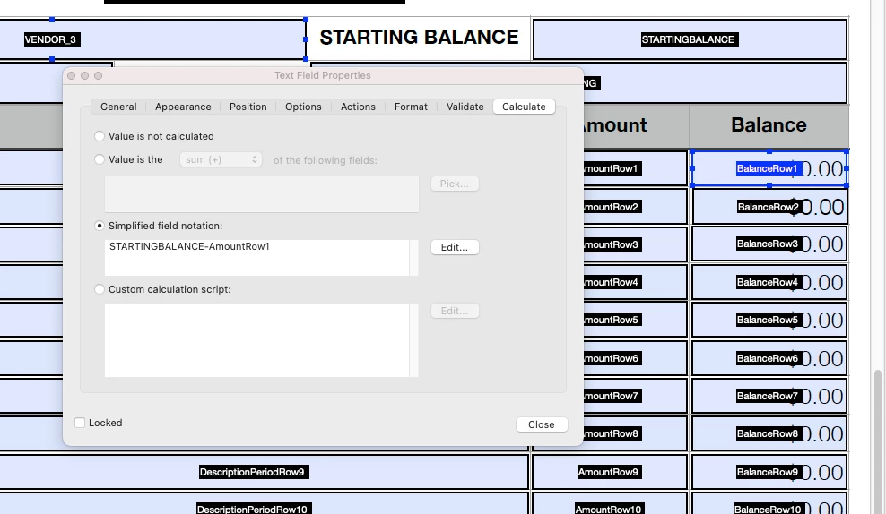

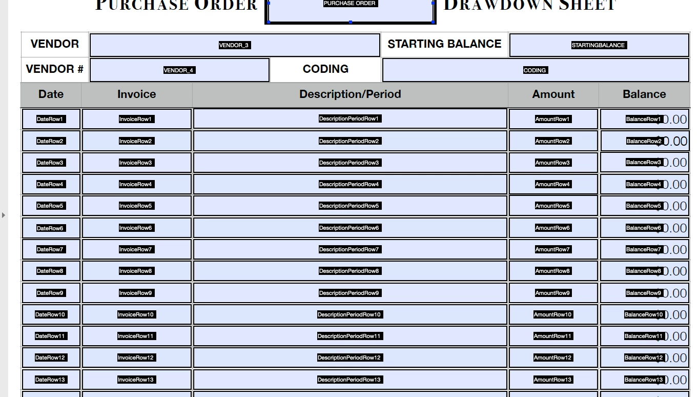

I've created a "drawdown sheet" that tracks reoccurring payments/invoicing on a PO.  I can't do it as a spreadsheet because it attaches to the pertinat PO which is a PDF.  A drawdown will have the starting balance (the amount for which the PO is written) and show the running balance as each weekly billing is paid.  I've attached a screen shot of the form and the issue.  The calculation is a simple subtraction from the previous balance but the issue is that the formula is performed down the sheet.  I tried to do an if,then statement:  If "2amount" is > 0 then "1balance" - "2amount", if else then leave "$0.00". Obviously that isn't Javascript but that is my problem - I don't spreak Javascript.  I scoured the web to find a solution and selfmedicate but it wasn't in the cards for me.  I even watched tutorials on basic javascript related to Acrobat but nothing stuck.  HELP!!

Gosh!  That was quick.  I've attached more screenshots to give more clarification.  Will I need to use quotes in referencing the field name?  Let me see:
event.value = 0;
if  (this.getField("AmountRow1").value >= 1)  event.value = this.getField("AmountRow1").value - this.getField("STARTINGBALANCE").value;
Then for the next set of fields:
event.value = 0;
if  (this.getField("AmountRow2").value >= 1)  event.value = this.getField("AmountRow2").value - this.getField("BalanceRow1").value;
Like that?
ls_rbls
Nov 24, 2020 9:51 PM UTC
No you don't use quotes with Simplified Field Notation(SFN) which is what you're currently using.
However, by using SFN  in your case above, it may limit the ability to use conditional statements in a formula or equation.
In my example, the value is the result of a Custom Calulation Script. In this case the syntax is expressed a little difefrent. That is why you've observed the use quotes and parenthesis for example.
Technical Generalist
