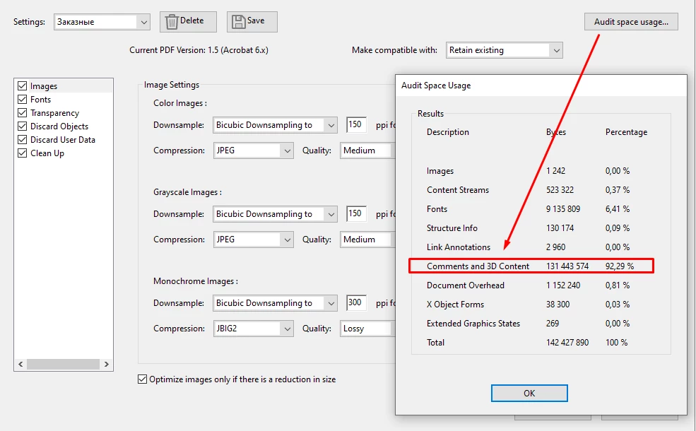

Hello everyone, I noticed such a problem: after hiding comments in a document using code, the file size increases tenfold!

After optimizing(File - Save as Other - Optimizide PDF) the document, the file size returns to its original size, but after displaying comments and saving, it again grows in size by + 3 MB, and so on each time after the hide/show/save cycle.
How to solve this problem? add file optimization to the main code? Or is there an option in the program settings that will clear this automatically?

after hiding the comments with the code, I save the file through the menu. Well, I most likely asked the question incorrectly, I will correct it: is there a function in the code similar to the Optimization button (I did not find it in the API)? I need that when my Hide button is pressed, the document is cleared at the same time, and the user does not need to do Save As.
