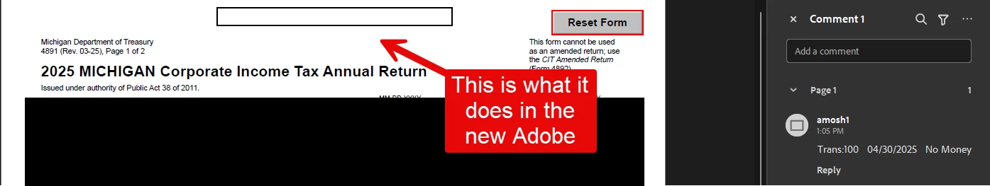

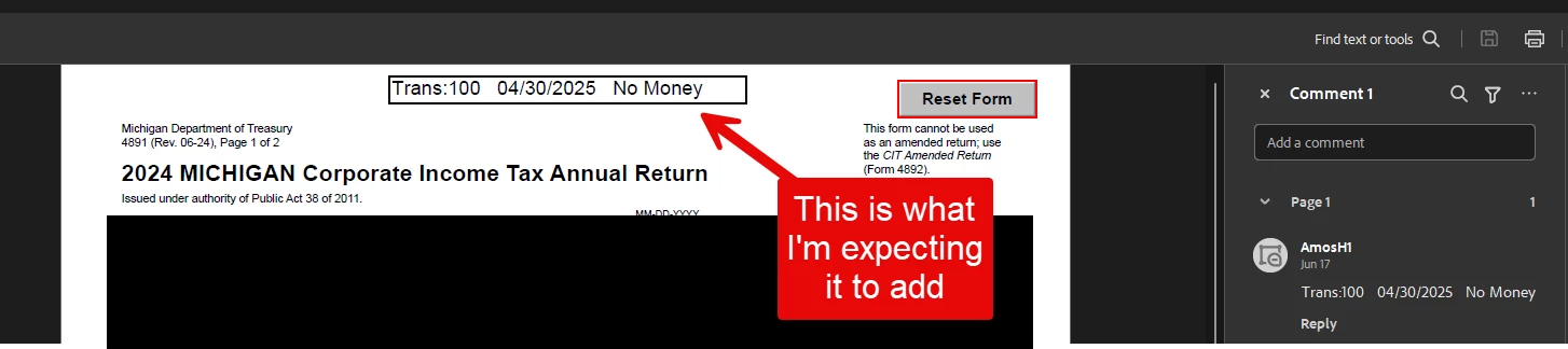

After going to the newer version (I cannot go back to the older version of Adobe due to company policy) it does nothing when I run this.  I made a small change and have it assign the type of FreeText first which then gives me a rectangle on the Form, but the text doesn't display in it.

What do I need ot chnage so I can add the type of text box threw the SDK to display the text on the form.
