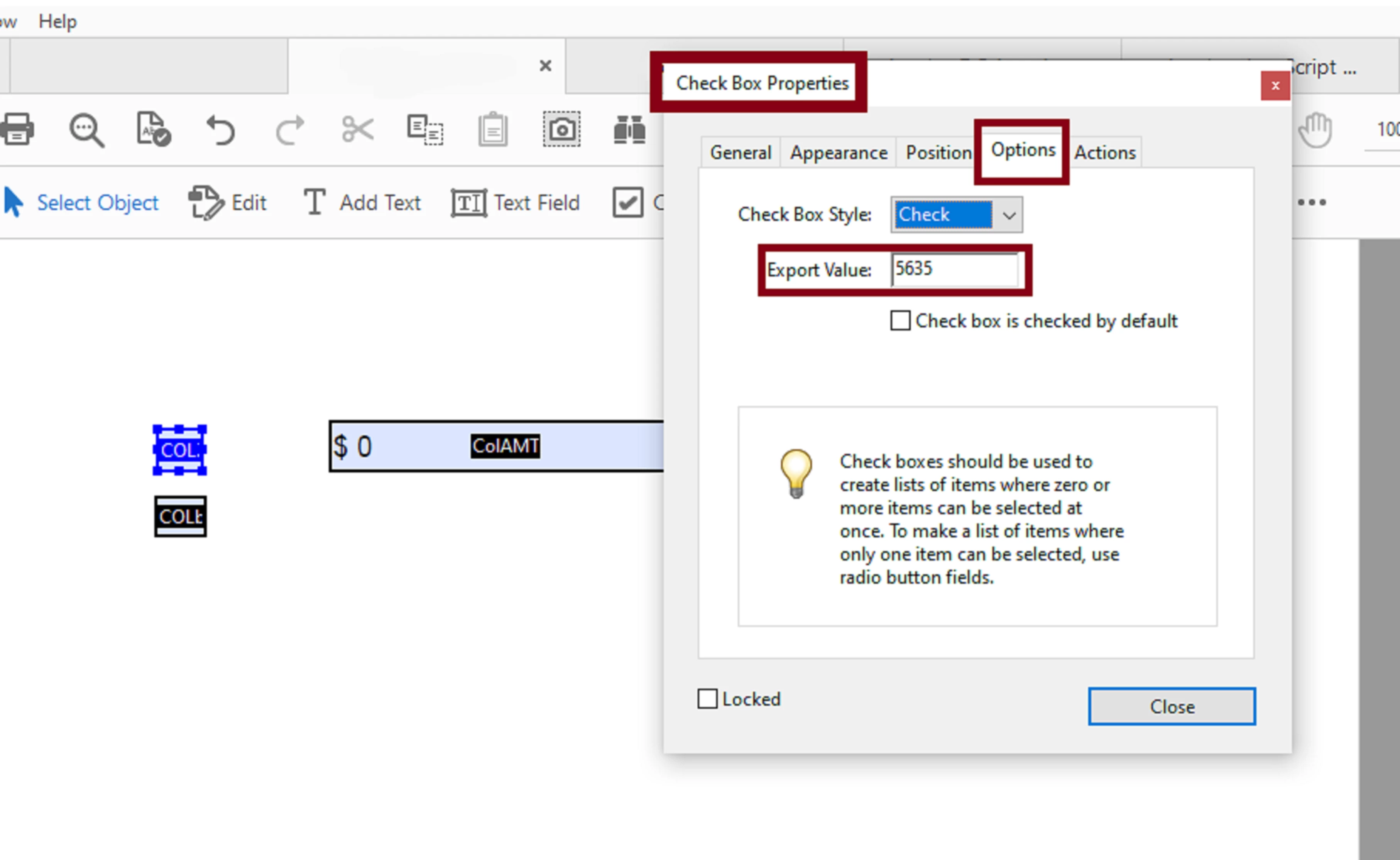

Hey courtney, I think that you're complicating the script too much.  Also your code is not JAVA; you're using Acrobat JavaScript.
For the checkbox "COLbox",  all you have to is set the export value to "5635" (without the quotes, of course). See slide:

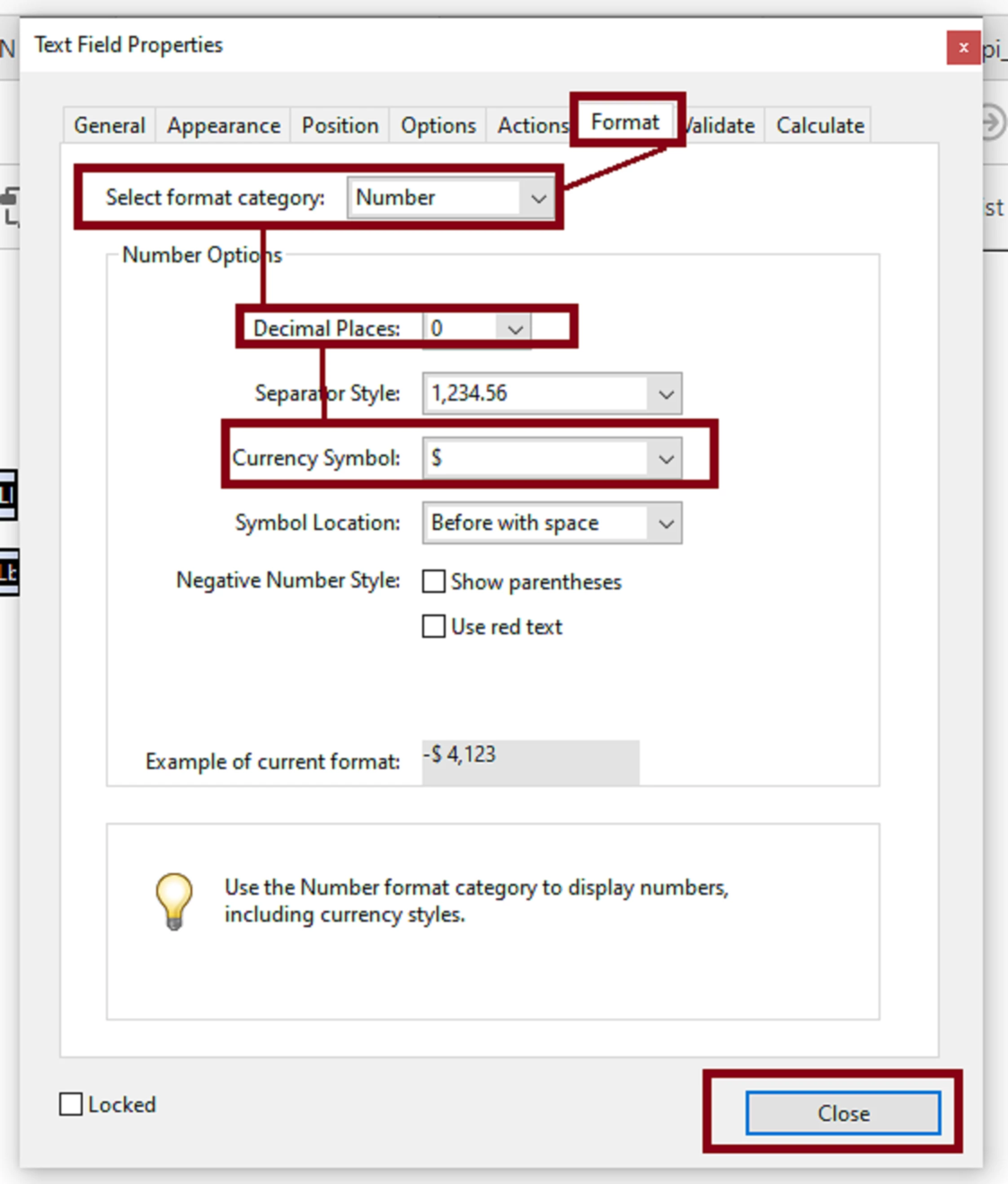

And then go to filed   properties of  "colAMT"; set  the  custom format  for Number and "$" using the Acrobat custom built-in formats:
See next slide:

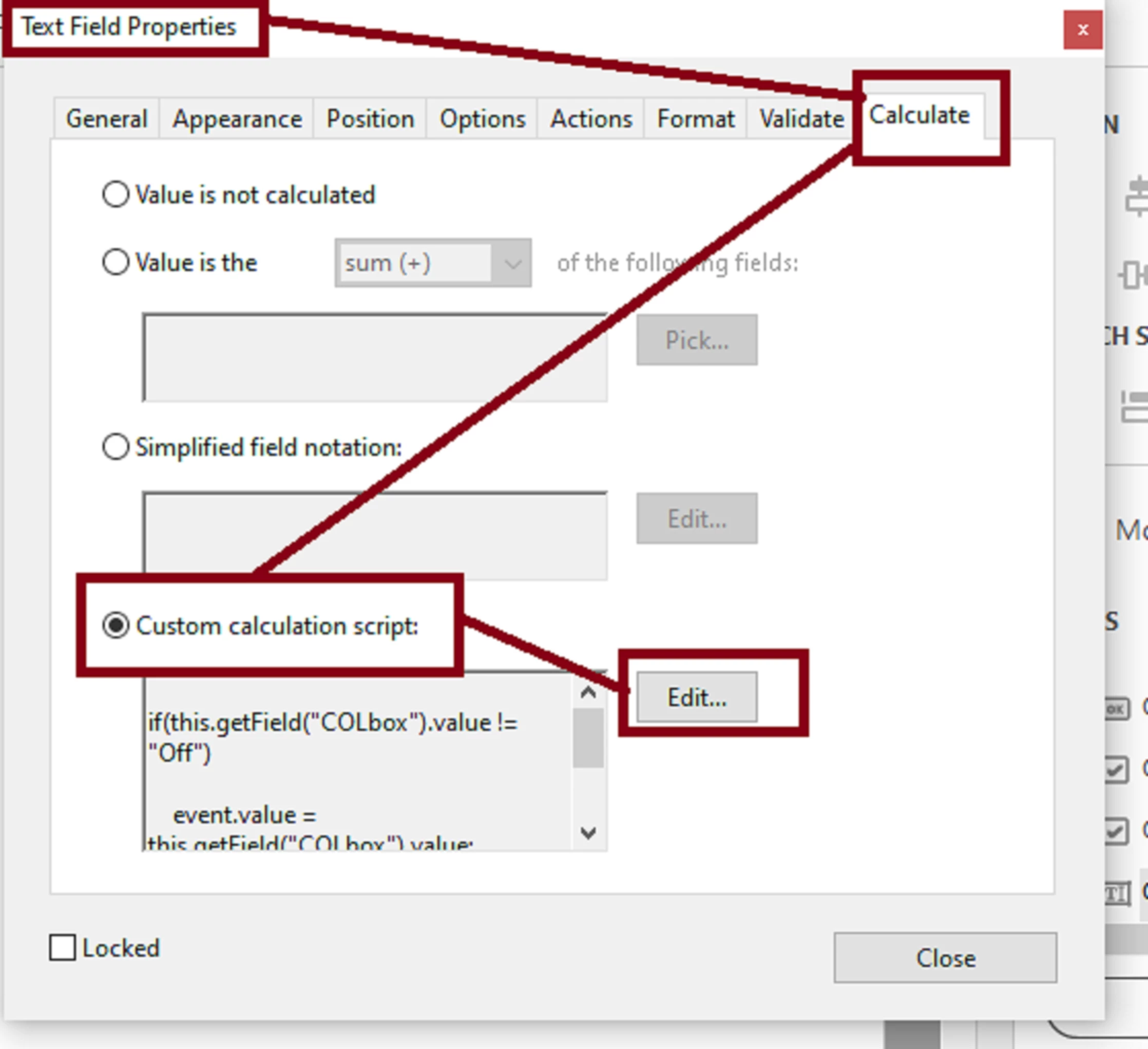

Next,  add the following custom calculation script to colAMT field:
if(this.getField("COLbox").value != "Off")
    event.value = (this.getField("COLbox").value);
See last slide:

ls_rbls
ls_rblsCommunity ExpertCorrect answer
Aug 7, 2020 8:31 PM UTC
See next slide:
See last slide:
