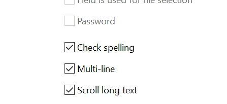

This is working for the most part. However, I would also like to add another default setting for text field, under the option tab only have the "check spelling" box selected.
Also, the current script is not being applied to checkboxes. I would like checkboxes to have the same default setting (Blue, 10) with the check box style set to "cross".

The "check spelling" is checked, but it is still auto checking the "multi line" and "scroll long text".

ultiline and scroll long text is not autocheked by the script.
That is a last remeber state on how the fields are created by default with those properties enabled.
Following Asim suggestion you can create one field with those property appearance preferences disabled  and then right-click  and select from the context menu "Use Current Properties as New Defaults". Then create your children fields based on this parent field.
But this can also be  manipulated via script.
you can add a line to your actual script like :
f.multiline = false;
f.doNotScroll = true;

Thanks for your help. All seems to work as intended. Is it possible to have the check box only have the "check spelling" selected and no other box? Currently the script is still selecting three options rather than just the one I want.
