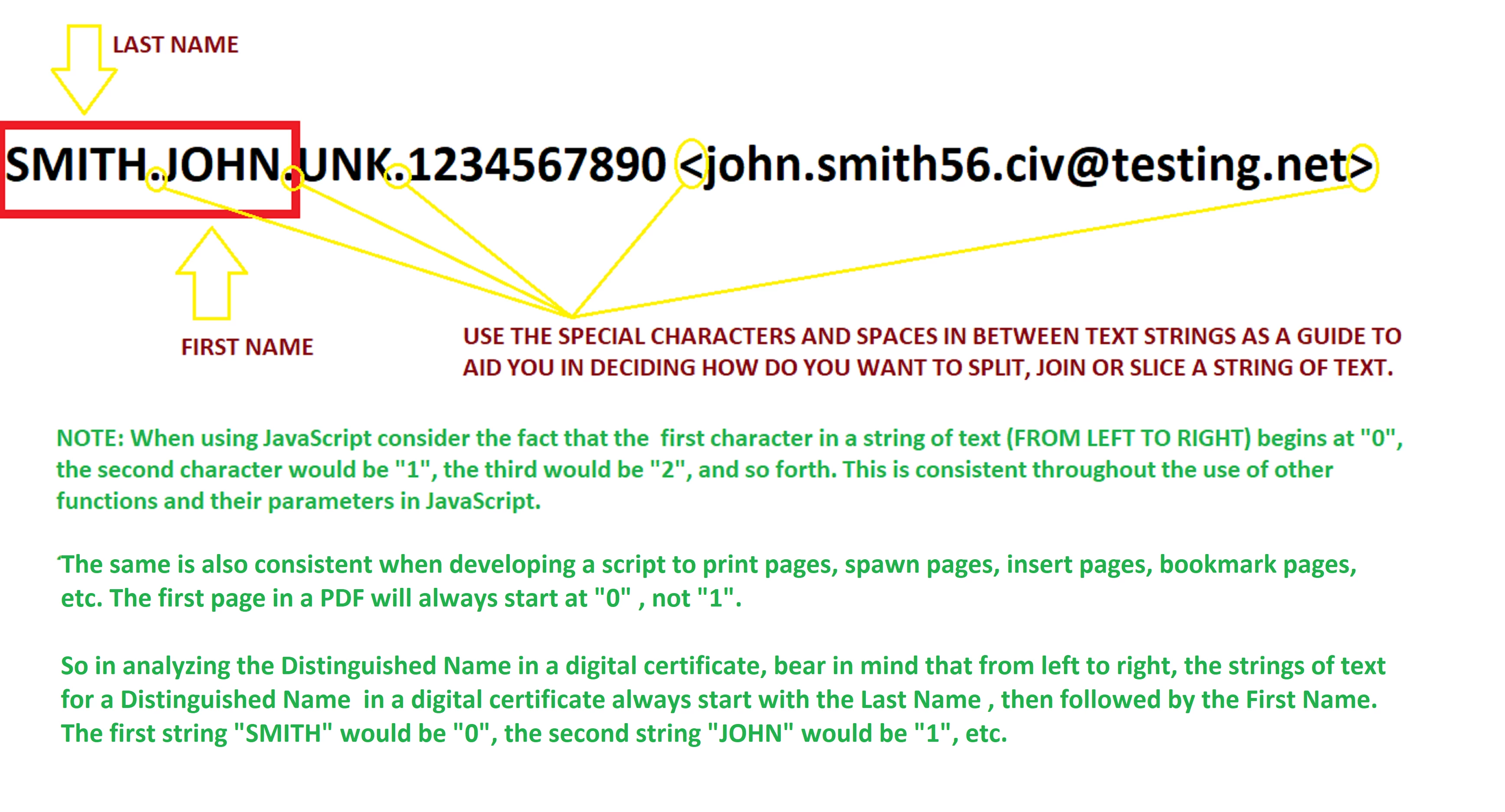

It looks like in the governement the common name of the user, as it appears in the digital signature after it is applied, is taken from the Distinguished Name of the certificate.
This makes things easier for us to figure out because when you get the value from cert.subjectDN.cn that is contained in sigInfo.certificates OR Info.name that is contained in signatureInfo you will get the same result : SMITH.JOHN.UNK .
If this wasn't the case, then when you extract this information to another text field it should read: John Unk Smith
The long answer to your issue is that you don't need to use an array to get this to work. Using the array method doesn't necessarily apply in your case because what you're dealing with is more related to international standards that are enforced with the use of digital signatures.
Some cultures use more than one first name, in other cultures the last name is also the surname, and in other cultures they have no last name at all.
The digital certificate standards that define the 'common name' schemas are not for the user(s) to choose a preferred method of signing, but an international standard as defined in RFC 1485 and the X.509 specifications for public key infrastructure certificates, cryptographic keypair association, and the Internet Engineering Task Force ( IETF ) Request For Comments (RFC) specifications.
These standards also encourage users to keep it as close as possible within the defined schemas of the international standards to aviod these problems when customizing a common name that will be used in a self-signed certificate.
For example, in order to get a specific string of text that is contained in a digital signing certificate, those special characters is what we use as guides to perform ".split" or ".join" methods from the Distinguished Name public component or from the user's identity key attributes.
Therefore, the employment of special characters, such as spaces (" "), dashes ("-"), periods(".") or less than / greater than ("<", ">") symbols, just make make our life easier.
See slide below:
See key attributes here: https://datatracker.ietf.org/doc/rfc1485/?include_text=1
See slide below:
Basics of Digital Certificates:
https://www.sites.google.com/site/ddmwsst/digital-certificates#TOC-CA-Hierarchy
Examples of key attributes:
http://certificate.fyicenter.com/717_Distinguished_Names_on_Certificates.html
Short Anwser:
You'll be fine just taking the first character strings from the First and Last name in order to compose the initials.
