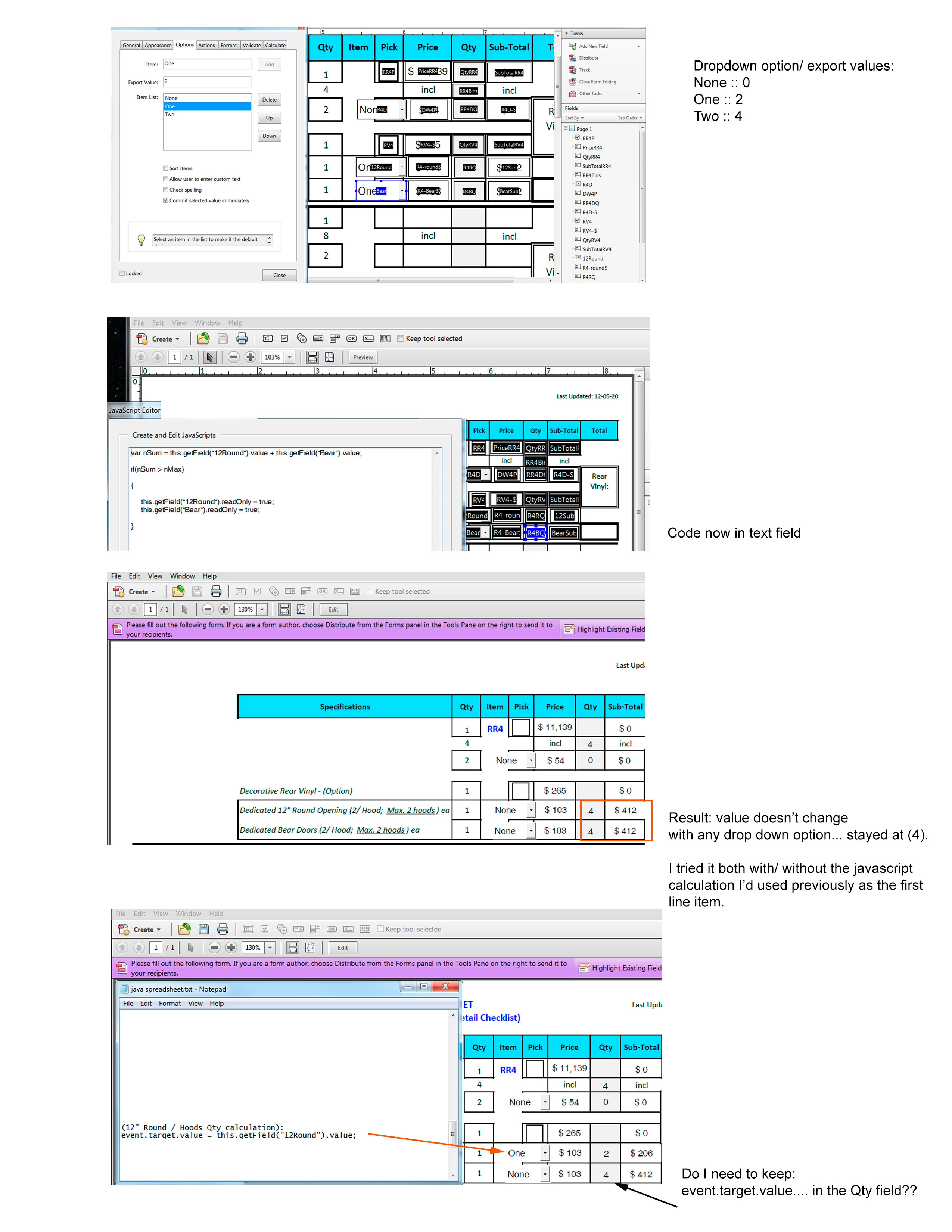

I'm very new to working with forms and javascript so please bear with me.
I've got two dropdown lists with export values used for simple calculation. (i.e.:  event.target.value = this.getField("12Round").value; in a separate text box)
Both of the dropdown lists have three options: None, One, and Two with export values of 0, 2, and 4 respectively.
The issue I have is that both are dependent on the other.
Example:  Take a box with two lids that can have two different sets of openings; Round or Square. When the dropdown choice comes up, the quantity outputs for each field work fine, however (2) of each dropdown can't be chosen.  Conditions that work are: (1) of either type, (2) of one type, or (1) of each.
Is there a way to have the dropdown box selections (freeze/ change colour?) as soon as the maximum is reached between both of them?
Thanks!!

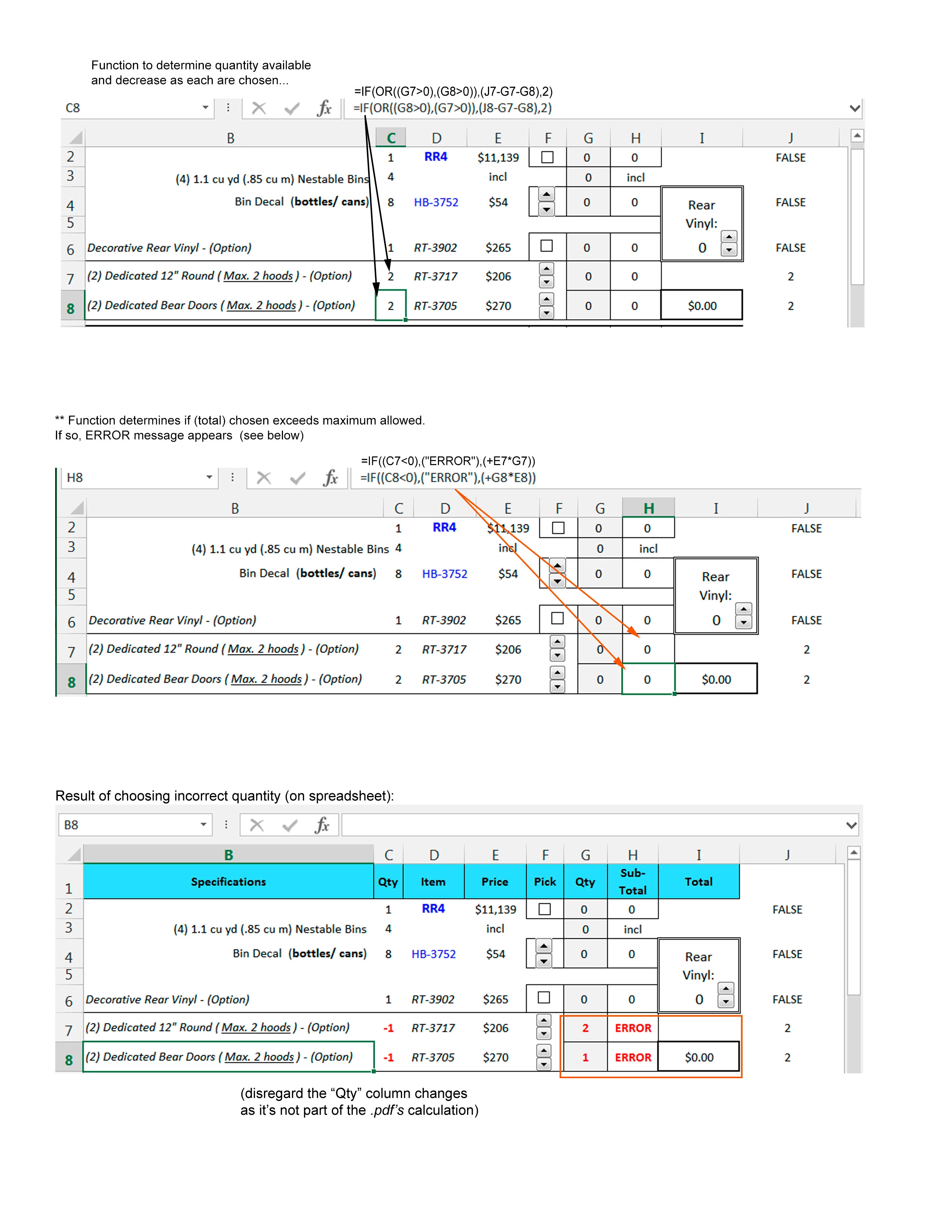

Unfortunately adding that line to the custom calculation script, no matter which line I put it on, doesn't change the result.  Here's the current script I have as custom calculation for the text field and I know the first line is the only one getting a value. I've tried putting this in as a validation script but same result... the nSum > nMax don't override.
Attached is a sample of how my spreadsheet responds when incorrect values are chosen.  Would a List choice option work better for this script?
var nSum = this.getField("12Round").value + this.getField("Bear").value;
var nMax = 4;
if(nSum > nMax)
this.getField("12Round").readOnly = true;
this.getField("Bear").readOnly = true;
Use readonly not readOnly

Unfortunately this didn't work on my form. Not sure what was causing two things to happen... first, both fields were still allowing the total values to show; dropdown not becoming a read-only. Then the formula wasn't allowing any calculation to happen.
See my attached .jpg and let me know if I'm missing something else, or have the formula entered incorrectly.
Thanks!
