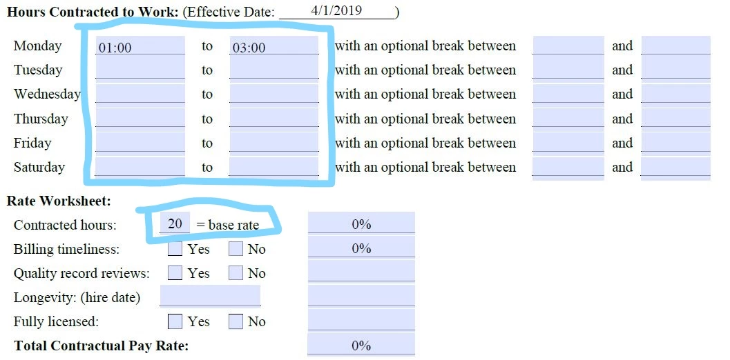

First, I need to calculate the hours being worked each day and total it in the contracted hours box. So I created a hidden text box to calculate that time for each day and have tried to include this formula for only MondayStartTime and MondayEndTime:
function dateTimeDiffer(startDTime, endDtime){
               var startTime = new Date(TimeStartMonday);
               var endTime = new Date(TimeEndMonday);
               var diff = endTime.getTime(TimeEndMonday) - startTime.getTime(TimeStartMonday);
               var msec = diff;
               var hh = Math.floor(msec / 1000 / 60 / 60);
               msec -= hh * 1000 * 60 * 60;
               var mm = Math.floor(msec / 1000 / 60);
               msec -= mm * 1000 * 60;
               return hh + “:” + mm + “:”;

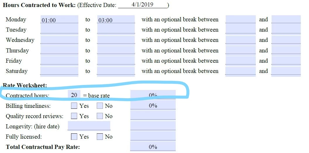

Second, I need the amount totaled in contracted hours to equal a percentage based on what is entered:
<20 = 45%
21-30 = 50%
31-38 = 55%
>39 = 60%
This is what I have tried so far. (The giant spacing only applied itself when I copied it into this forum).
var n = this.getField("ContractedHours").value;
 if (n < 20) {
    event.value = "45";
else if (n >= 21 && n <31 ) {
    event.value = "50";
else if (n >= 31 && n < 39) {
    event.value = "55";
else if (n >= 39) {
    event.value = "60";

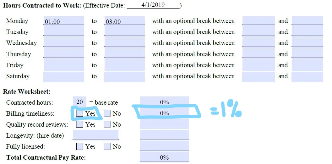

Next, I need to add 1% for each "Yes" that is checked. This is the formula I tried to use:
function myFunction() {
  var checkBox = document.getElementById("Check Box7");
  var text = document.getElementById("Text21");
  if (checkBox.checked == true){
    text.style.display = "block";
  } else {
text.style.display = "none";

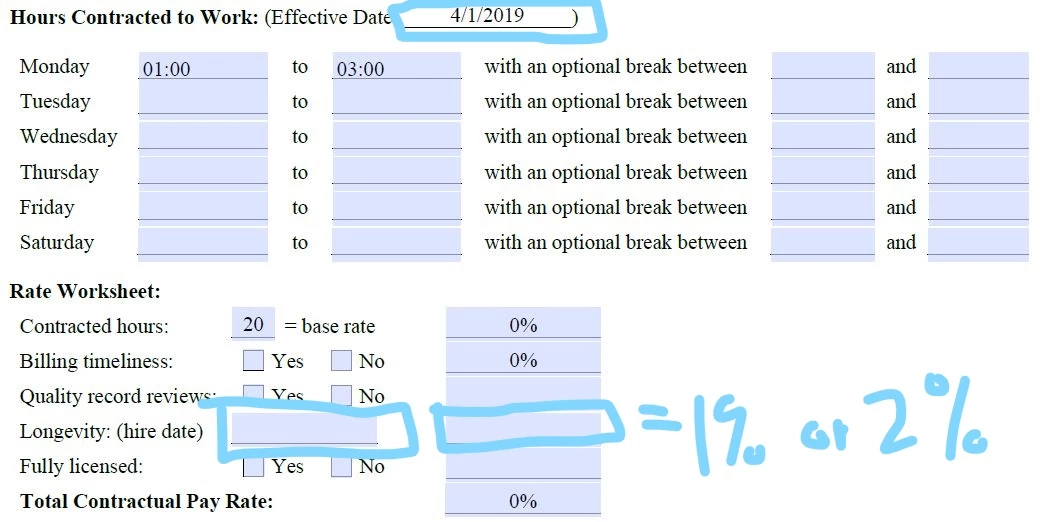

Last, I need to calculate longevity with the organization based on the hire date compared to the effective date (4/1/2019). If the years equal 5 to 9, they receive an additional percent. 10 or more, they receive 2%. I realize that this is two different formulas and in two different boxes. I do not have a formula for the second part of the process.
  1. if ( not DateTimeField2.isNull ) then
  2.     var startDate = Date2Num( DateTimeField2, "YYYY-MM-DD" )
  3.     var currentDate = Date()
  4.
  5.     var years = ( currentDate - startDate ) / 365
  6.     $ = Floor( years )
  7. else
  8.     $ = ""
  9. endif
