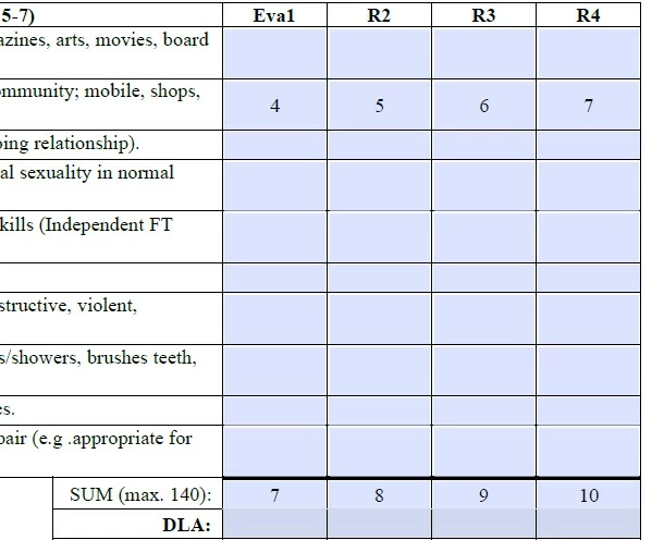

Needs average of four columns of fields but ignore zeros
I have a form with four individual columns that need an average calculated, but with the zeros ignored.  Below is what it looks like.  The fields in each column are either E.  R2.  R3.  R4., wish sequential numbers after each dot. The averages need to calculate in the DLA  row. (Keep in mind this page two, there are numbers on the other, bringing up the sum at the bottom).
I've come across different codes but I am understanding they have to be a document level. How do I do that when I need four different averages?

Then for the DLA boxes, I am guessing I am supposed to run this script, but I am not sure how to write my form field names. For the first column, would it only "R1"?
calcAverage(["Knowledge1", "Knowledge2", "Knowledge3", "Knowledge4", "Knowledge5", "Knowledge6"], true, true);
So, questions - are these the correct scripts I need to be using and how do I make it work for my document? I have basic knowledge of JS. I really just need someone to tell me what to put and where to put it, and what I need to replace with my field names. Please and thank you so much!

You would call this script from the custom calculation script of your respective DLA field. Let's say you are working on E.DLA (we don't know what your naming convention for the DLA fields are, so I just assume that's the average field for the E column).
You would call it with all field names that you want to average in a field array as you've shown in the example. I don't know how many rows you have, so let's assume it's 30, you would need to create an array with these 30 field names, and then call the script:
var fieldArray = [];
for (var i=0; i<30; i++) {
    fieldArray.push("E." + i);
calcAverage(fieldArray, true, true);
If you have a different number of rows, you need to edit the for expression.
You would add something corresponding to all four DLA fields.
Oct 9, 2020 6:15 PM UTC
There are 20 rows. So, in each of the DLA fields it would look something like this? This is for the first eval column:
var fieldArray = [E];
for (var i=0; i<20; i++) {
         fieldArray.push(E + i);
calcAverage(E, true, true);
Karl Heinz  Kremer
Oct 9, 2020 6:50 PM UTC
Your script is different from what I posted. Use my script. You don't have to make any changes for the "E" column, just for the ohter three columns. Are your fields named E.0 ... E.19 or E.1 ... E.20? My script assumes the first case. If it's the second, the for loop need to be changed:
for (var i=1; i<=20; i++) {
try67
Oct 9, 2020 5:36 PM UTC
Yes, this is the correct script to use (which I wrote, by the way!)...
You need to place the function part in a doc-level script (Tools - JavaScript - Document Scripts), and the call to it as the custom Calculation script of your Average field. If your field names are R1, R2, etc. then change that call to:
calcAverage(["R1", "R2", "R3", "R4"], true, true);
That's all there is to it.
Oct 9, 2020 6:05 PM UTC
Thank you for responding so quickly! You are always so helpful!
So, I input the document script above as it is written at the document level. Then I only need the average of each column not a total of all of four columns, so I tried that calculation script in one of the DLA text fields, but only used "R1" and it didn't work. Then I created a separate field with a calculation script as you have it written above, and nothing happened. I must be doing something wrong but I can't figure it out. Do I need to change out any of the names in the document level script with my fields? aFields means all fields, yes?
