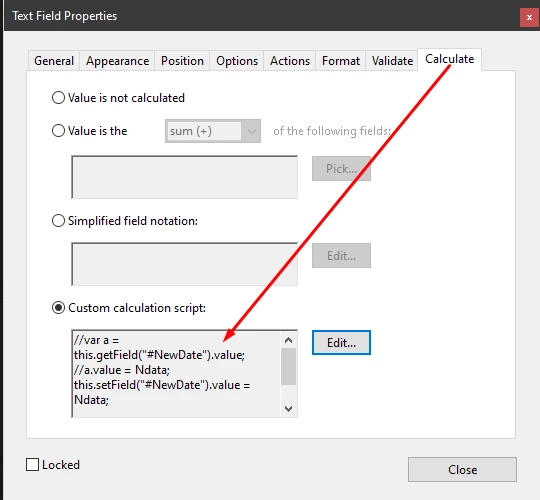

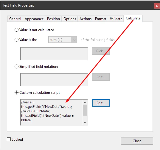

Hi all,
can't figure out how to pass the value of a variable from the main code to a form field?
In main code i have
var Ndata = EditTextValue.split("+", 1)
this.addAnnot({page: i, type: "Stamp", rect: X1, author: "", AP: "#NewDate" })
it doesn't work...
//var a = this.getField("#NewDate").value;
//a.value = Ndata;
this.setField("#NewDate").value = Ndata;
and it doesn't work that way...
var d = this.dataObjects[0];
d.setFieldValue("#NewDate", Ndata);

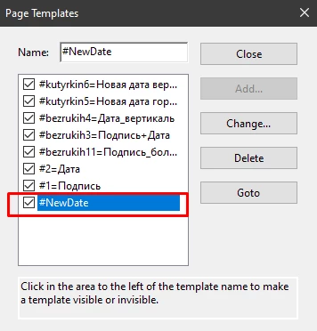

Dmitriy K.
Sep 28, 2021 1:27 PM UTC
Script logic: the user enters a new date in the edittext field (execDialog), and then refers to the stamp template that I created manually and placed in C: \ Users \ 1 \ AppData \ Roaming \ Adobe \ Acrobat \ DC \ Stamps.
Earlier my code looks like this, and it worked, the cMsg value was transferred from the main code to the stamp:
var cAsk = "Enter new date";
var cTitle = " ";
if(event.source.forReal &&
   (event.source.stampName == "#NewDate"))
   var cMsg = app.response(cAsk, cTitle);
   event.value = cMsg;
   event.source.source.info.DocumentState = cMsg;
...but then I redid the code to get the new date value via edittext (execDialog)
