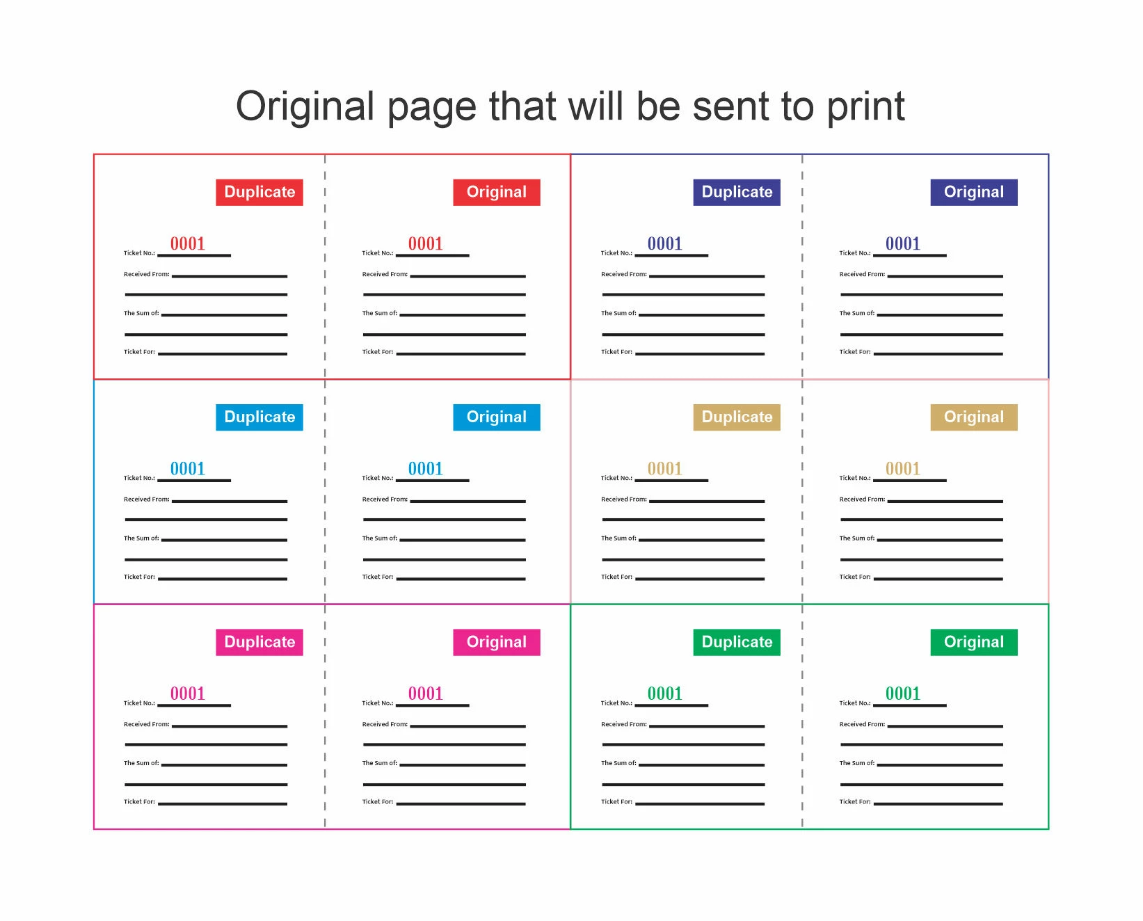

Please and please i need help getting my following attached adobe form on my PC to generate new sequential serial numbers on the specified "Ticket Number" field on the form during each print. I print lots of copies of this template, during the production, i want the form to be able to generate serial numbers on the specific field just like the illustration attached. say i send 1,000 copies of the form to print, the numbers should be generated accordingly till the last copy.
Please i will appreciate any support to this request. Thanks

Doing that requires using a script, and you can't use the Copies field in the Print dialog because that only prints identical copies of the file, so each print needs to be in a separate command.

Ok, thank you try67,
are you saying it can only work like the following?
May 11, 2020
Again, you can't us the Copies field of the Print dialog to do it. You need to do it using a script that both sets the fields and prints the file in a loop.
Thank you so much try67 for writing me back, like i said in my other post, i have decided to unify the values per page, in the following manner:
so that when it prints it give output the pages in the same following incrementing orders:
Now, this is what i have been able to come up with, i just want you to help me check possible what is wrong here with my code.
