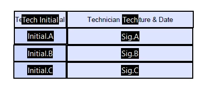

I have a form that users are to enter their initials or ID# after each step is complete. There can be several users completing this form leading to several unique entries. At the end of the form the users will print the document and physically sign their name next to their initials. I'm trying to figure out how to have the initials automatically populate next to a signature box.
I've created a field hierarchy called Init "Init.10, Init.11,... " to enter initials for each job step and fields at the end of the form to put the initials/ID#'s (see below).
I've been able to use the following code I found to iterate through the "Init" fields and display the values but it only displays the first value it sees. I'm thinking I need to have the values put into an array and put the first initial into the "Initial.A" field then use an if-else statement to check the contents of the array against "Initial.A" and if it matches go to the next element in the array and place that in "Initial.B" and repeat. If that's correct I'm having trouble seeing how to do that.
I played with pushing the aNames.value to the arr array and setting arr[0] equal to Initial.A but it didn't work. Any suggestions or guidance would be helpful.

Thom Parker
Thom ParkerCorrect answer
Feb 27, 2019 8:11 PM UTC
Ok, so let me paraphrase the goal here.
1)  Collect all the values from the "Init" fields.
2)  Filter it to removed blank and non-unique entries.
3)  Write these remaining entries into the "Initial" fields.
So here's some code to do this.
// #1 collect all values into an array
var aAllValues = this.getField("Init").getArray().map(function(a){return a.value});
// #2 Filter to remove blank/non-unique entries
var rgEmpty = /^\s*$/;
var aUsed = [];  // This is for collecting the unique values
for(var i=0;i<aAllValues.length;i++)
     if((aAllValues !=null) && !rgEmpty.test(aAllValues) && !aUsed .some(function(a){return a==aAllValues}))
             aUsed.push(aAllValues);
// #3 put into fields - For this I'm renaming the fields with a number "Initial0", Initial1" etc
for(var i=0;i<aUsed.length;i++)
     if(i>3) break;
     this.getField("Initial" + i).value = aUsed;
Thom Parker - Software Developer at PDFScriptingUse the Acrobat JavaScript Reference early and often

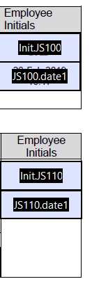

Bastaw
BastawAuthor
Feb 20, 2019 11:26 PM UTC
Thanks Thom, unfortunately I can't ensure that users will always put their in initials in an "A" or "B" field.
The fields i'm pulling initials from are labeled as below. The Init.JS100 or Init.JS110 indicate which job step (they increment in 10's so these are step 10 and 11). There could be initials "BB" in the Init.JS90 (step 9) & Init.JS100 (step 10) field and "TP" in the Init.JS110 (step 11) field. I'm trying to have the program look through all the Init fields and see there are two unique initials and place one in the Initial.A field and one in the Initial.B field
