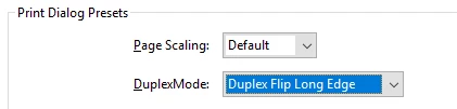

Hi there,
How can I change default value of DuplexMode property in Print Dialog Presets to 'Duplex Flip Long Edge'? I need every new PDF file to be created with duplex mode by default. Any suggestions?
Or is it possible to achieve this programatically, say using JavaScript etc.?
