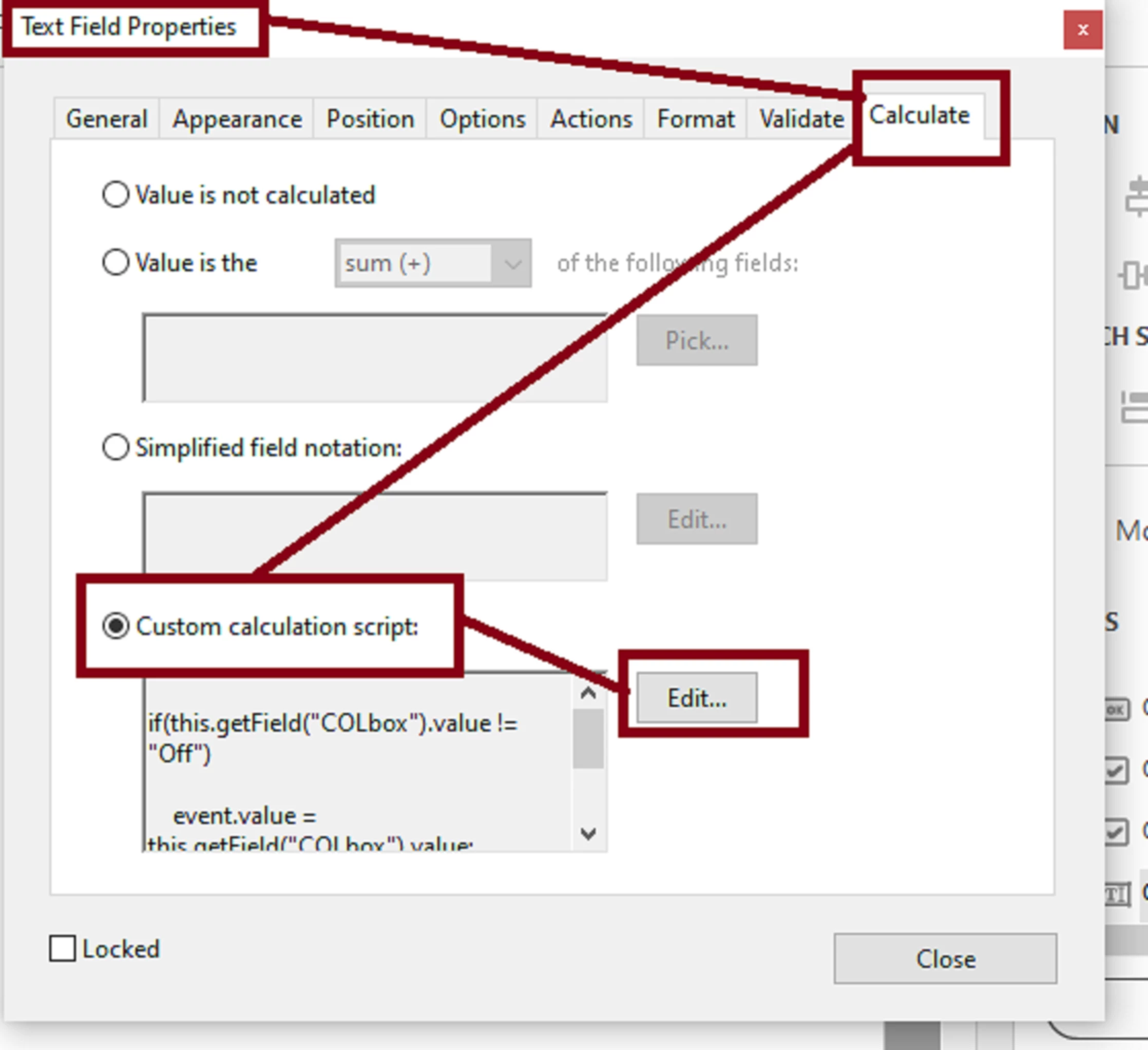

ls_rbls
Nov 13, 2020 6:23 PM UTC
Adding to this discussion,
See the slide below:
