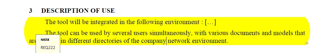

I am trying to create highlight annotation for the selected text over multiple line.

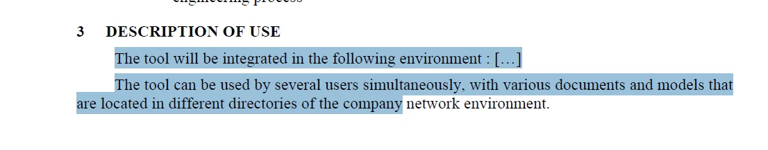

For example, see in the below image:
This is my selected text. Now when I apply the annotation to this text, it looks like below:
That means selection is getting extended while applying the annotation.

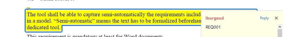

Now I am able to create annotation. But the problem is when I select the annotation, selection border does not seem good.
Here is the snapshot when I select my highlighted annotation:
And here is my latest code:

Selection border should look like below:
What am I missing or doing wrong here?
