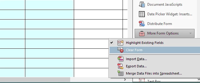

rakeshk21205956
May 19, 2020 11:14 AM UTC
I tried 3 methods of resetting but still the last calculated value remains... i don't want to make a RESET BUTTON to reset the field .... i want if the user deletes the value individually the calculated field resets itself..
1. RESET the form via inbuilt adobe acrobat > CLEAR FORM
2. INDIVIDUALLY deleting all the values from each field.
3. Made a button  and through ACTION tab > RESET A FORM ... this also doesnot work
None of them resets the calculated field.
