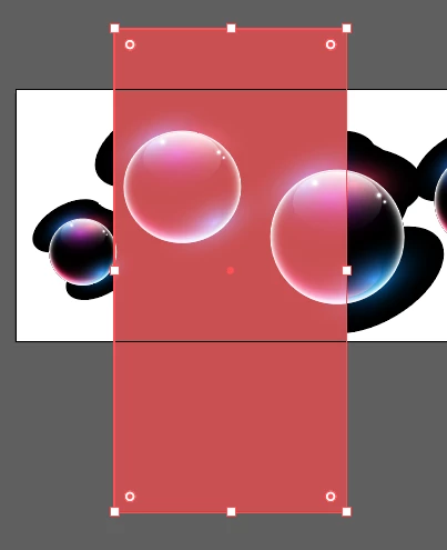

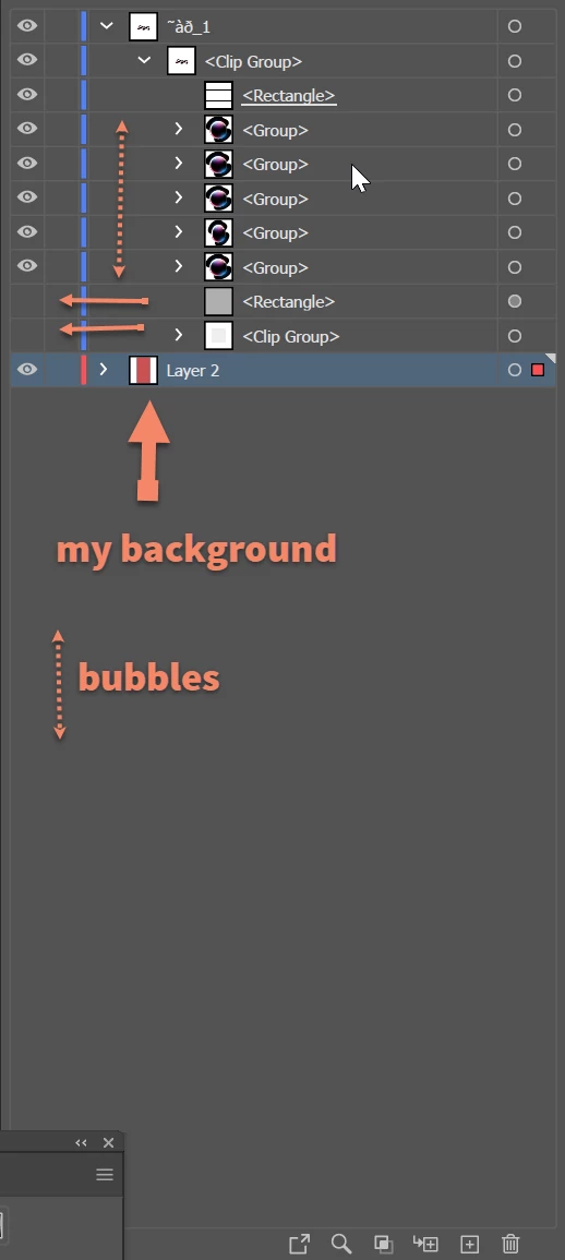

Apr 20, 2021 8:26 AM UTC
Transparency with such illustrator files works only against colour backgrounds.
You see my red rectangle works fine with the bubbles. To the left and the right of the rectangle I have an empty background (shown in white, but there is no background fill so what you see is the default visual of a 100% transparent artboard. I have switched off the visibility of the chequerboard and a grey background from the original visual. Here is the layers' palette:

Abambo
AbamboCommunity ExpertCorrect answer
Apr 21, 2021 3:31 PM UTC
I do not know what you are intending with your file, but all transparency effects that I've seen so far work only against a background. That background may be someting complex like a drawing or a photo, but the effect cannot exist by itself.
