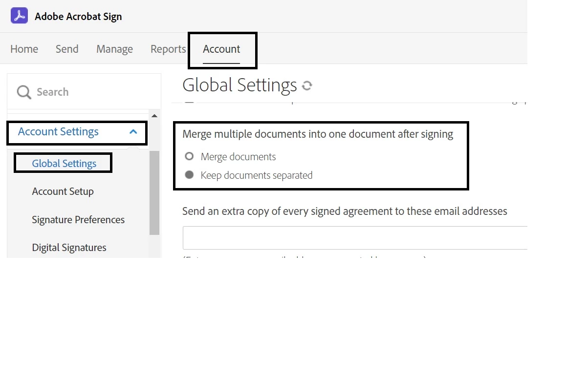

Hi Paula,
We have checked your account and see that you have the Acrobat Sign team plan.
When you send more than two documents for signature at once, they will be sent as a single document to the signer. The document will be attached in serial order.
To receive each document individually after signature, you will need to enable the settings as Sritama suggested. However, the feature is not available with your current plan.
As mentioned above, the radio buttons and form fields on the first document got linked to other documents. Would you mind elaborating on it? Also, let us know how you have added form fields to these forms.

Hi Paula,
I hope you're doing well. It is probably happening because your Sign account sdmin has enabled the setting for merging the documents together after being signed. Attached is the exact setting that needs to be toggled in order to keep the documents seperated.
Please let us know if it helps!
