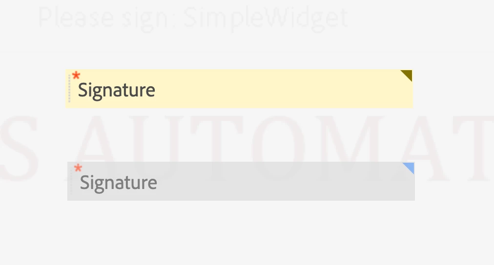

Even if you add 2 signature fields, both the fields need to be assigned to different signers. You can do that by double clicking on the Signature field and changing the 'Assigned to' value.
The colored ribbon on the top right will be different to confirm that both fields were assigned to different signers. It should look something like this:
If you have done this the right way, and still facing issues, please attach a screenshot of the actual document which you are trying to author to help me understand the issue better (It is kinda difficult to debug it remotely though 🙂 )
