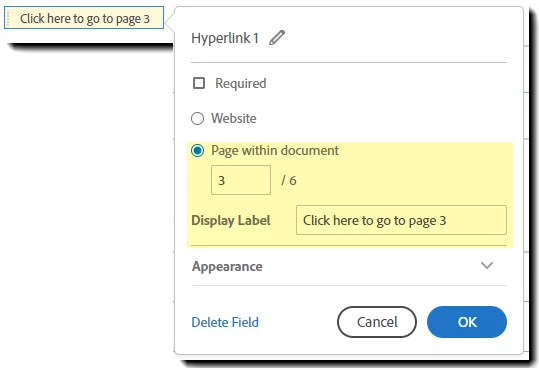

You can't use a checkbox or radio button, but you can use a Hyperlink.
  1. Add a hyperlink and open the properties.
  2. Select the option to jump to a Page within the document
    • This takes you to the top of the page; there are no anchors, so you can't get super targeted
  3. Edit the Display Label field to provide the text you want added as the linked text on the form/agreement
Hope this is helpful!
